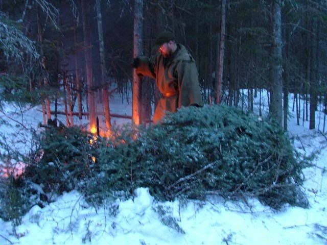

The picture I posted is the "morning after" shot from a simulated "separated from camp" scenario. When I started the night, it was 1hr before Sunset and -26C. I had only my base layer and a wool shirt on. (A knife and firepouch are also glued to my side when in the bush.) This is typical dress for slipping out of the tipi to take a quick leak. Can a person get lost taking a pee? Yes, it happens quite often, according to SAR records. So don't count on always having your tools when you need them.
Different environments call for different approaches. In the Southern States (typically... excluding deserts and high mountains) there is no rush for shelter or fire... unless you are cold and wet, hypothermia is not an immediate threat. The wood is workable and building materials are abundant in most areas. Water is in liquid form and food (to the skilled woodsman) is usually accessible. In my training environment, water and food is locked into ice and snow, wood is frozen and Earth is frozen. (When frozen, dry wood and wetwood are almost indistinguishable from eachother, BTW... and fatwood is like metal... it sucks) You pretty much lose all motor skills in 1hr with improper, or compromised protection from the elements. You are not afforded the luxury of time and options in extreme environments. (hot or cold)
At times like these, all bets are off. Proper knife use gets dwarfed in comparison to keeping your ass on this plane of existence. Dulling your knife now, means you'll be alive to resharpen it later... not just a dead dude with a sharp well taken care of knife. So you can speak from personal experience, that's fine... but making unfounded, generalized blanket statements in an attempt to trivialize my own experience is uncalled for, IMO... even in jest. Only after you've stood beside me and lived what I've lived can you tell me I'm wrong. (That really is an invite, bro.... I'd love to have you two up here sometime.)
