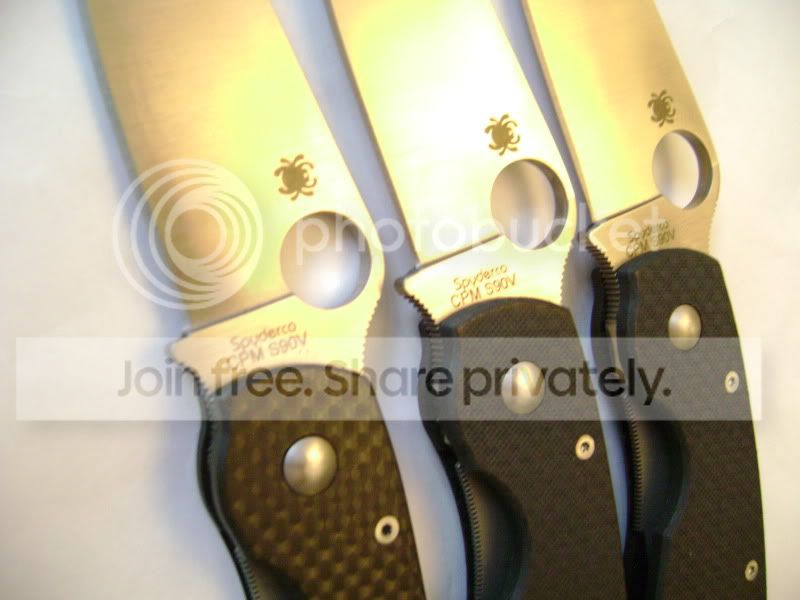

"From what I understand, the M4 Military came to be from conversations MCM had with Roger. The knife eventually came to fruition because of those conversations. I'm guessing that it was planned from the beginning to be a Ti framelock with G-10 non locking side."
Roger asked me what I thought folks wanted, I thought this one up and just knew it would fly.
M4 Ti & CF Military, drilled tip up or down.
Only changes were G-10 rather than CF, and std clip.
(Added cost was thought to possibly scare some folks away with the above options)
(And the surprise steel / stop insert.. Huge Bonus!)
15 months later, here we are.
Planning a run in CF & S90v, unless another super / SS shows up.
Maybe next summer?
A very small MCM on the blade would be a nice touch! LOL LOL
For what's its worth, I am very happy with mine.
And yes, a tip up CF S90v Military is hard to beat. Light, large & sharp!.
There is another nice 4" LE on Roger's site. Looking forward to that one as well. :p
