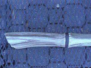

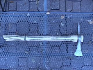

here's mine
There is a feed store down the road from me that has been in business for over fifty years. There is a bucket that has a collection of handles in it, all of which are for sale. The lady at the counter told me that some of the handles had been in the bucket for over 20 years. I grabbed a bunch and replaced the stock handle on my CS Lagana. It is dangerous to hold; it makes one want to scream at the top of ones lungs and charge into a crowd and start reducing numbers. Fortunately I live far from crowds...
The eye of a tomahawk is formed with a different type of drift than a hatchet or ax. A tomahawk has a larger eye, more egg or teardrop shaped. This allows the handle to slip easily in from the top of the eye and wedge itself into the eye without having to use an additional steel or wooden wedge . The top of the hawk handle is wide enough so that the head will wedge up tight during use without slipping off. The advantage of this method is that if you break a handle doing whatever, you can pretty easily shape a new one in the field with your knife or the hawk head itself. A typical curvy hatchet handle doesn't tend to be able to slip into the eye as easily as a straight one, if at all.
Now I like that!!!

That is a very special paint. It is sold exclusively at most hardware stores and was purchased for this project at a place called Home Depot. You have probably never heard of it. I believe that 'camoflage' was somewhere on the label. Good luck!
