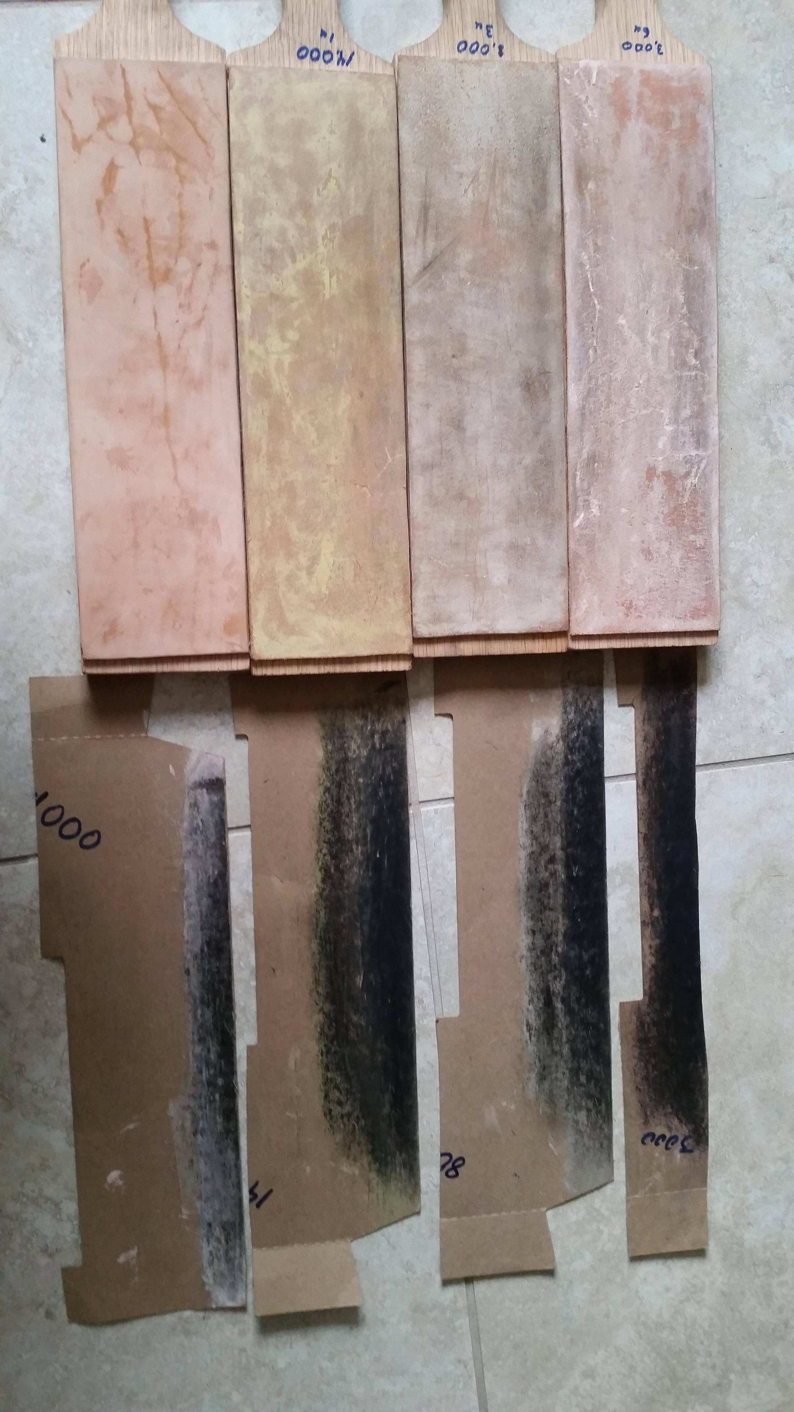

Altogether

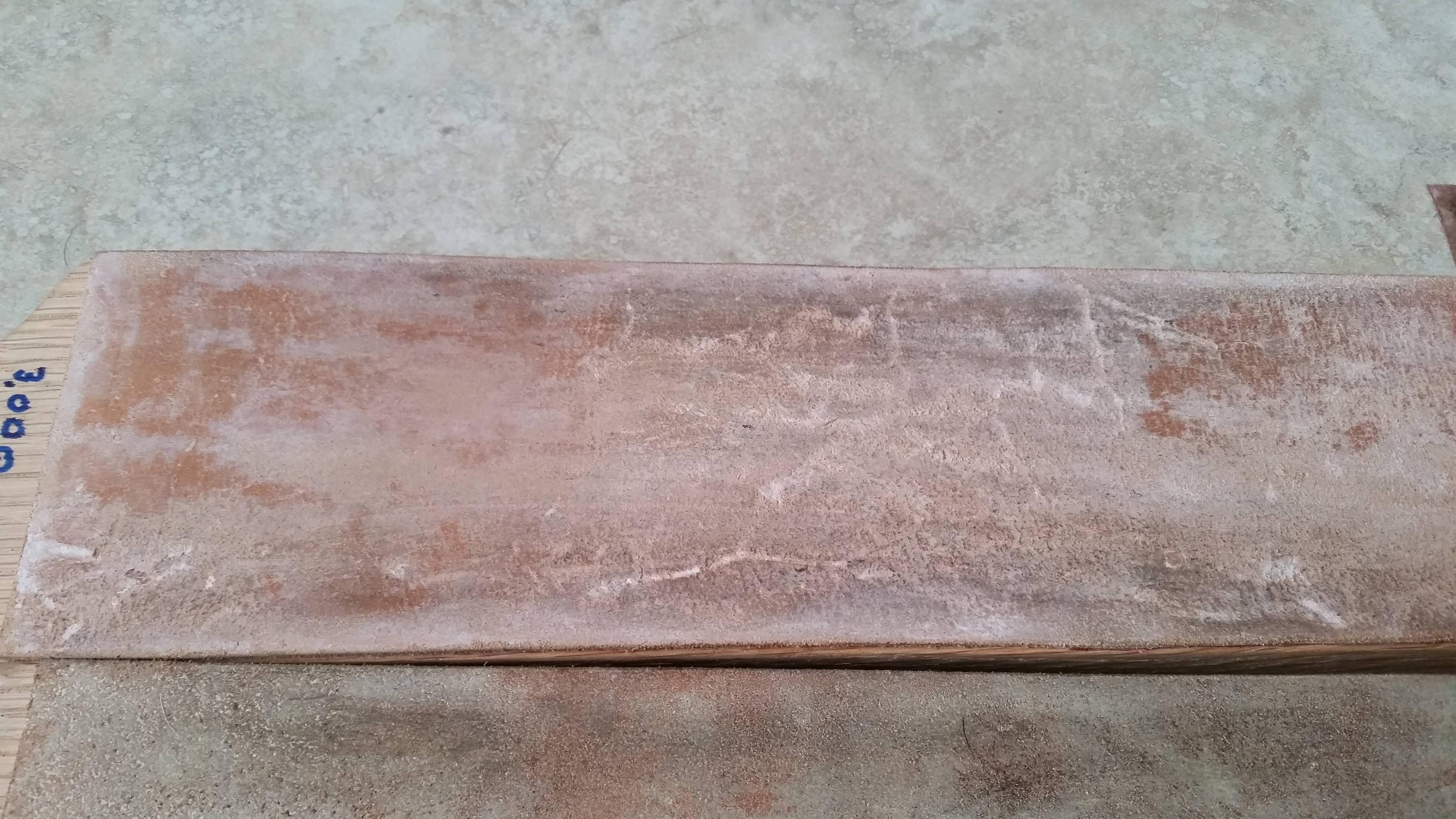

Type and thickness, smooth side after light sanding to remove test compound.
Coarsely sanded, unevenly absorbed. As you can see, almost none of the leather strops were good at what they were supposed to do, opposed to the cardboard which obviously works well with the same compound.

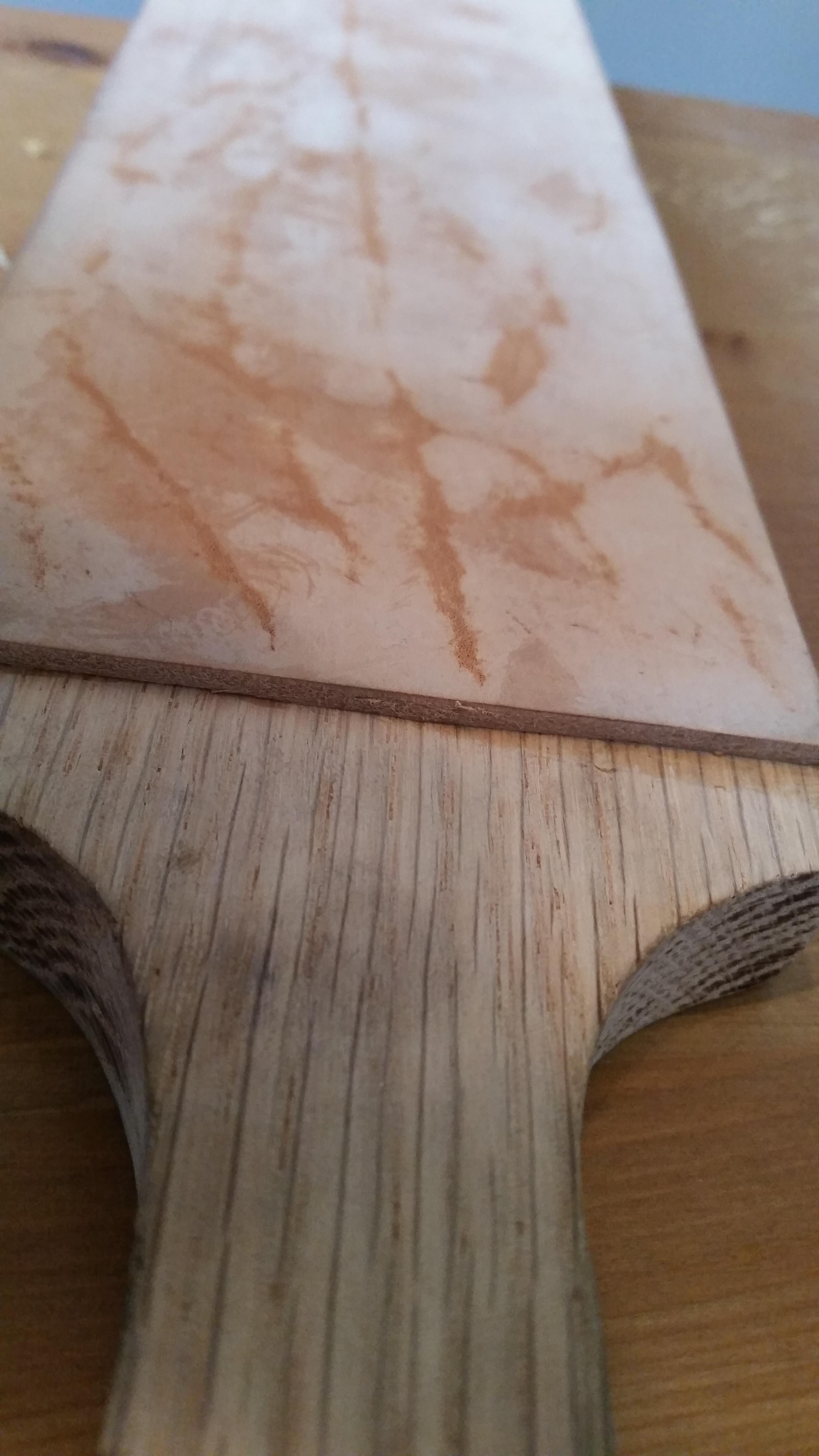

Interesting... This is your 'after removing,' yet it looks like my 'after applying.' Actually, a rather bit more compound than I'd apply before I begin to strop.
It obvious from your pictures that you are getting results from your cardboard strops, so why not just stick with that? There is no
requirement that you use leather.

Just trying to figure out if I'm doing something wrong. On the one you referenced I only applied a little bit because it was smooth side up. After letting it sit a couple of days I tried using it and the compound came right off so I sanded it a little bit with about 2000 grit sandpaper. What you see there is basically bare leather (with random coffee/beer stains because I don't have a use for the leather so I stopped caring about keeping it nice and clean).
I don't believe it's latigo. I think it's just bare, untreated leather.
I don't know if it shows up well for you but the second strop from the right was the smooth side up, roughed with (300 grit?) sandpaper and with a little bit of heated compound mixed with a little bit of mineral oil. It did the best but the results aren't very good. I used those strops multiple times and for far longer than I really should have needed to. There wasn't any metal being polished nor removed. That's when I went to using the cardboard. I never figured out if it was the leather itself or how I processed it for use or if cardboard was just more efficient. I kind of assumed it was a combination of all three. No matter how I look at it though, cardboard works and was much easier to obtain, really efficient to use, and disposable. I guess I'll stick with it.

OK... First off, if you're happy with the results you are getting with cardboard, stick with it. Nothing wrong with using it.
But... if you want to try a good leather strop, here's what you need to do:
1. You need to process the leather before you do anything. Untreated leather just won't work nearly as well. Wet it under the sink for 10 seconds, let it dry for about 30-45 minutes, then roll it with an ordinary rolling pin for 5-10 minutes, bearing down on it, compressing the leather. Longer is better. Then let it dry for two days.
2. For this one, I'll skip the leather conditioner, but if it were me, I'd rub in 3-4 pea-sized dots of shoe cream (NOT wax shoe polish... shoe cream.)
3. Take your bar compound and LEAVE THE MINERAL OIL IN THE CLOSET. Using the compound like a crayon, pretend you are 3yrs old and just rub a dozen streaks back and forth over the smooth side of the leather. Do NOT try to cover the leather. Wad up a piece of rag and rub the leather for 2-3 minutes, moving the compound around.Do NOT worry about getting an even coat. All you are doing is spreading it around.
4. Brush off the excess compound. A lot will come off. Don't worry about it. There is now MORE THAN ENOUGH compound on the surface to do the job correctly. Yes... I know that to your eyes, you might not 'see' compound, but keep in mind that compound is actually microscopic. You don't need to see it for it to work. It doesn't have to be a layer so thick or even that it looks painted on.
You now have enough compound on a properly processed strop to deal with 20-30-40 knives. After that just repeat the crayon work and the rubbing, and keep stropping on a strop that will last 100 years. No need to sand it. No need to scrap it. If you want to clean it in the future, just wipe it down with lighter fluid, Coleman Fuel, naptha, or mineral spirits (NOT mineral oil... mineral spirits, often sold as Odorless paint thinner.)
