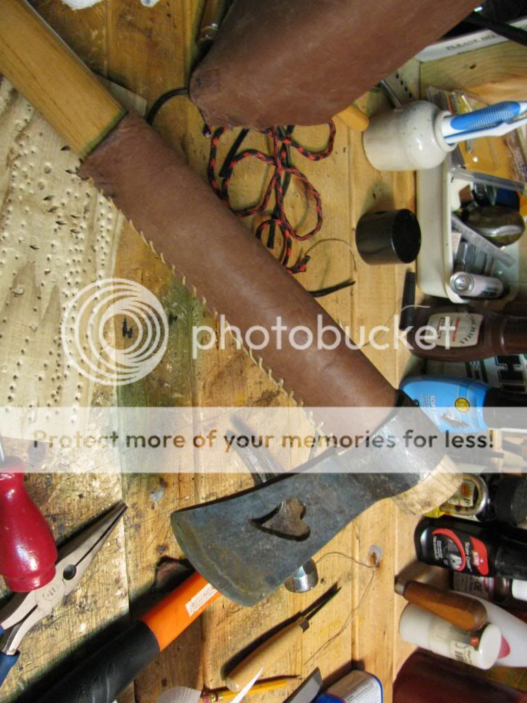

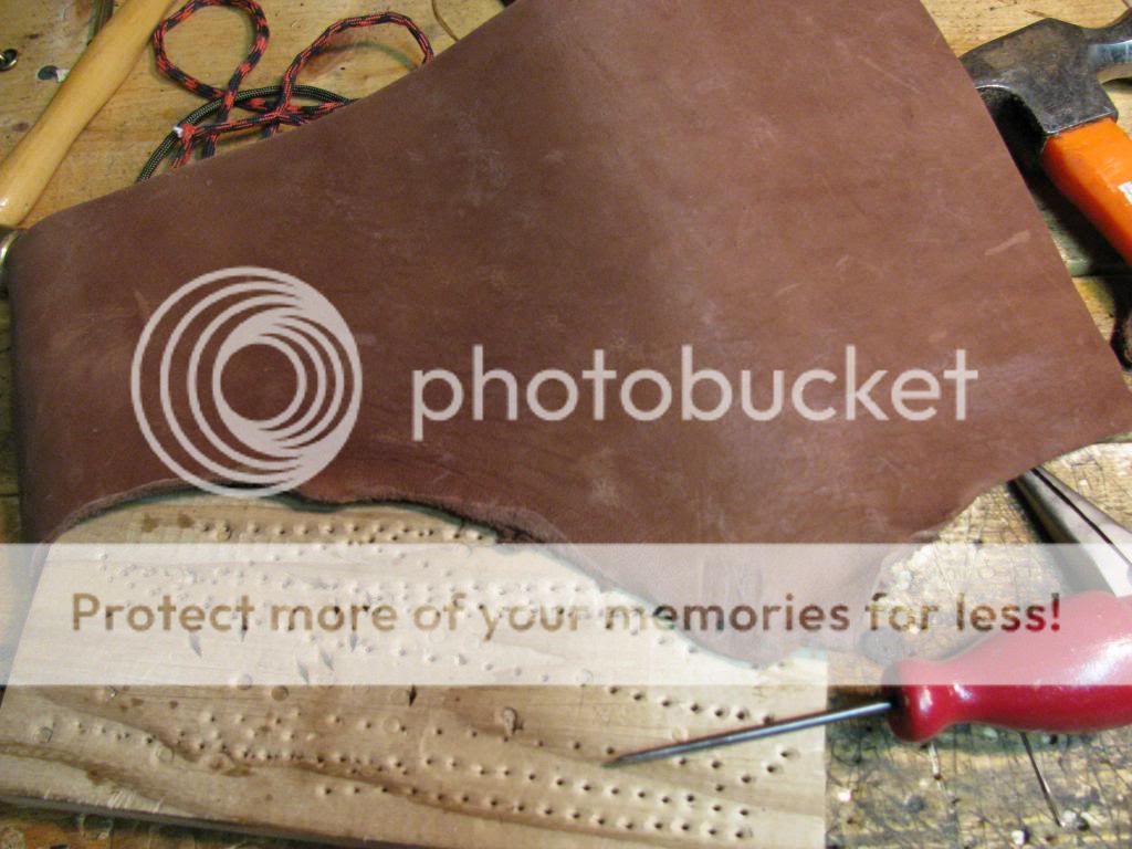

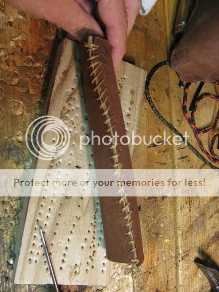

You need to work on the fit for sure. I would personally also avoid using any set screws Cold Steel supplied. They tend to have these in their hawk heads but they can start a split. You have to carry around an allen wrench to remove them and removing the head can be a good thing. If the head is fitted well it won't move much. It also helps to put something that increases friction (again like shoe goo) on the haft under the head. I like that stuff because peels off and doesn't effect the handle at all. The slip on will greatly reduce damage and shock to the head but no, it will not prevent the head from slipping down. The slip-on's are just friction fit tight. If they get loose get them wet and lay them out in the sun for a day and they just tighten back up. I had a few minutes this morning so just stitched up a leather one for you to see. It took less than thirty minutes, started out as an old boot top and I didn't even bother to keep my seam straight. But it will work fine, look woodsy and protect this hawk. I made the hawk head at my forge about 1983 and I have thrown it thousands of times. It has had three handles that I can recall in all that time.

Be sure to turn the seam toward the front of the axe. That is the thickest and most protective part of the slip-on. It needs to be where it will protect the best. Also, if you decide to make your own handles and are into the whole correct grain orientation thing, try some good hard and dry holly. It grows naturally in straight lengths that can be cut when it is just too large for a handle. Put them up to dry for a year and you will have some hard and tough handles! My wife has me out there cutting that stuff every year and we just decided to save a few for walking sticks about 20 years ago. After drying, we could not bend them or break them at all (they were about 1" diameter and 6 feet long). Since then I have used them for spear shafts, hawk handles and even some very strong bow staves.
I would recommend it for any hawk. If you are just going to practice with it and use it around the house, I'd use cord wrap. But if it is going to the woods with you and be seen by others, a slip is great. Again, you can take it off when not throwing if you like or decorate and leave it on. I think the cord is maybe a bit more protective but the slips look right for most axe throwing historical periods. Just use fairly heavy leather and whatever you stitch it with needs to look period. For instance I used artificial sinew on the one above. I've stitched them lots of times with dental floss and used brown shoe polish and a brush to make them look more acceptable.

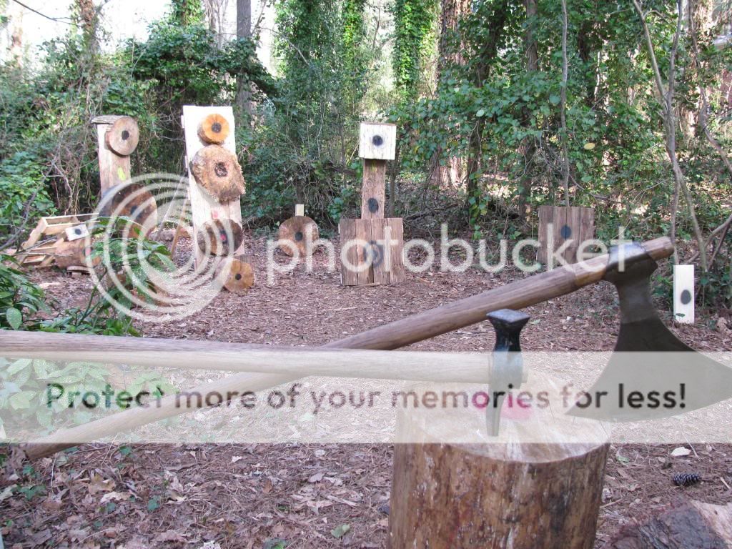

By the way, my old Cold Steel war hammer and my Danish War Axe got new hafts today. I am bad about using my war hammer in the winter to help with my firewood. Just hit the spike into one side of the log, use the long handle as a lever to flip the log and the hammer becomes the fulcrum so that you can chainsaw easily by yourself. Not too many barbarians around to use the hammer on so this is my main use for it. I think I bought this whenever they came out many (?) years ago. This year I finally rolled a locust tree that was just too much for the hammer haft. You notice I have the head on upside down. The eye is tapered so it is easier to get a heavy duty handle in place that way.. And we are generally not using the hook to pull folks from horses these days. So the hook works better for my purposes turned up.
Evil-looking implement you've got there. Not difficult to see how ululus (Inuit skin fleshing tools) came about. One way cuts the other scrapes.
