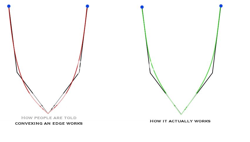

I'd like to preface this by stating that these are my observations only. Feel free to disagree--in fact I encourage it! If there's a fault with my reasoning I'd like to correct it. :) This is a long post, so here we go!
If there's one thing that everyone likes, it seems to be convex edges. Users often state how impressed they are with their performance. However, the oft-touted belief is that a convex edge has more material supporting the blade, and thus has better edge retention than a conventional "V" edge. This makes sense at a cursory glance because the shortest distance between two points is a straight line, and so a convex would mean there was more material and a concave would have less, right?
Sort of. A convex edge traversing those two points (the apex of the bevel and where the bevel transitions into the primary grind or blade stock) would have more material supporting the edge...but would also have a broader effective edge angle meaning it would have to displace more material during the cut and at a more rapid pace. This is really the dynamic of the old broad vs. thin edge angle tradeoff, and you can't add material back onto the blade anyway so the only way to increase the supporting material is by diminishing the blade height through sharpening so we push the red lines back into the thicker region of the blade. You can see that that would start removing a lot of blade pretty quick, and at the cost of cutting performance as well. What we really need to be looking at is a "V" edge being converted to a convex of equal effective edge angle. What you get is something like this:
So you can see that what you're really getting is a reduction of the transitional shoulder, giving you a thinner geometry but maintaining the same edge angle and without significantly reducing the material supporting the edge where it typically needs it most. This makes for a smoother cut (increasing controllability due to the more gradual shift in geometry) but also reduces the amount of material that must be displaced by the blade as it passes through the cutting medium. This means that your cuts require less energy, yet the edge is still almost as well-supported as a conventional "V" edge.
Given the actual realistic benefit provided by a convex edge, this is why I tell folks to not worry too much about maintaining a perfect convex edge when out in the field. If you're a perfectionist you can always restore it to "true" when you get back to the house. Besides--freehand sharpening results in slight variation in angle from stroke to stroke so you end up with a very slight convex form anyhow. :)
Most tests in which folks have been impressed with the edge-holding abilities of convex edges have been batoning their knife through a bunch of wood and then still been able to shave their arm at the end. Impressive, right? Well once the edge goes in the edge rarely actually touches the wood! The parts of the bevel either side of the edge and the bevel of the primary grind take the brunt of the action since the wood splits ahead of the edge itself. The convex edge doesn't significantly play a role in this effect other than perhaps allowing the split to start a little easier. Cross-grain batoning would be another matter, but little comparative testing has been done between two otherwise identical knives of equal edge angle with "V" and convex edges to provide substantive evidence for any sort of improvement in edge retention. If there is one it's simply that for equal amounts of force applied to each blade the thinner convex one will be able to cut deeper, and thus cut more material for equal energy expenditure, but the actual sharpness of the edge (or the thickness of the apex on the terminal "edge" bevel) will be affected about the same since it has the same edge angle and degree of wear resistance.
Discuss!

When I look at edges like in the diagrams above, I think the edge does cut better/with less force, but it's because metal was removed from the cross section, not because the surfaces are curved instead of flat.

Bingo. My point exactly. The only advantage that the curvature gives you is the "feel" of the cut is perhaps a hair smoother and that can give the user a greater sense of control...or not, depending on how closely they're "listening" to the tool in the first place. The only significant advantage is that it's a little thinner in cross-sectional geometry without sacrificing a ton of material immediately at the edge. You can produce a similar effect by "sharpening" at a shallower angle than the edge for a bit to take some meat off of the shoulder. You'll then have the 3 bevels with the terminal bevel (edge) being a tertiary one rather than secondary. :)

They shouldn't have any improved edge retention unless you thin out the material immediately behind the edge since as the apex of the bevel wears you're creating a plane and the thinner the material behind the edge the thinner the apex will remain as it wears. That, of course, comes at the cost of durability, and the edge will be more susceptible to damage.

Here's another thing to think about. The diagrams of the convex surfaces above can have a flat/faceted bevel fit inside them, and then another convex inside that, and so on until we reach a triangle from spine to edge (Nikkala anyone?). Whichever geometry you choose, it can always go thinner until you reach that point. After that, if you convex, it starts beefing things back up, or the blade starts to get narrower from spine to edge.

Exactly. And that has to do with edge angle. The "triangle" you refer to would be a zero full flat, like a wedge straight razor. The very thinnest the edge can get without reducing spine thickness. :)

The major "fault" in your OP is that you seem to assume that everyone starts with some standard flat-ground/V-edge geometry and then convexes it. You're certainly right that removing steel does not make a blade stronger.
However...
Airplane wings and splitting mauls and baseballs are convex for a very good reason. Pushing a flat plane through any material (lots of surface area in contact at once, which means lots of friction and drag) requires more force than pushing a curved surface through it. The difference in performance may be completely undetectable with a blade designed for whittling hairs from a baby unicorn's bottom, but may really shine when subjected to "hard use" (whatever that means).
My point is, a few manu's and many custom makers start with convex edges and/or bevels in the first place, and adjust the relevant angles and edge thickness/keeness according to intended use.

The purpose of my discussion was specifically to address the trend of folks to convert standard "V" or linear edges to convex ones, so yes it does make that presumption. There would be, after all, no need to convert an edge that already came as a convex. The items you mention--airplane wings, mauls, and baseballs--don't really make a lot of sense when it comes to this discussion. Airplane wings WOULD make sense the most since you're dealing with a tapered form passing through a medium (air) but the reason for the convexity is to harness Bernoulli's Principle and provide lift. A (presumably splitting?) maul is not necessarily convex--I've seen many that weren't. German-style splitting axes are concave, in fact. Baseballs are round to provide a concentrated mass that does not require orientation to the target. If you had a paper airplane as heavy as a baseball its pointed shape would pass through the air with less resistance.

Yup! Stock thickness contributes significantly to sectional volume so the thicker it is generally the more mass must be displaced, and more energy is spent pushing that material to the sides than it is towards passint the edge deeper into the material.
