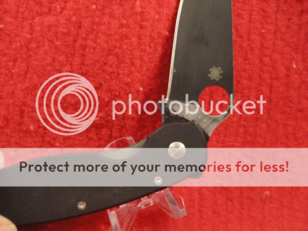

this is the millie s30 used by knarfeng in the tests quoted by effer. the rockwell was confirmed on 2 different hardness testing machines. notice the multiple dimples on the tang, the coating was removed to get correct readings. maybe the mirror bevel by ankerson is slightly seeable.

I remember that knife. :D
A knife well traveled. :)

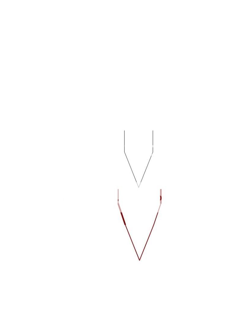

IIRC, the Military is thicker at the top of the bevel than is the Vantage Pro. That can make a difference in the force required to cut. A thicker blade is harder to get through a thin material like toilet paper.
Here is a rough sketch of two blade outlines. Both have the same primary bevel angle. But the bottom one is thicker at the top of the bevel. Is there any doubt in your mind that you would have to exert more force to get that wider wedge through than it would take for the thinner one above? (This is a rough sketch, but the angles are actually exactly the same.)
When it comes to cutting effectiveness, geometry is more important than blade alloy. The Military meant for more robust service, so it has a thicker blade right above the edge. The Buck Vantage Pro is a slicer, so it is thinner at the edge.
That makes a lot of sense. Thank you for making that sketch. It put things into perspective.
