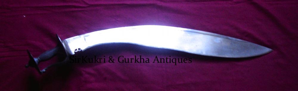

Here's three antique blades showing some extreme variations from VK Kunwor. What these hope to show is that there is no unified design and that explanations heavily reliant on the form are somewhat flawed.
The purpose, function or meaning of this blade feature is currently a mystery, no matter what anyone tells you. There are hundreds and hundreds of explanations I've seen for this feature and I'll list a few notable ones in order of least sensible to most likely, with a bit of explanation.

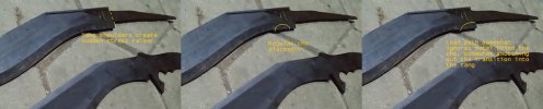

My personal hunch about that notch is that it was developed to relieve some physical stress on the blade (as discussed above) and became stylized over the years, smiths adding it because that's how it's done (also as discussed above) without a deep understanding of its purpose or optimal shape. This lead to artistic interpretation and, in some cases, a maker's mark. Just my theory, of course.
I've been thinking about it more recently as well, but it's a bit of a counterintuitive thought process.
I've made a simple diagram to help explain. Very small text so please full screen.
This is a blank of one of our rat tail tangs without a cho. As you can see the transition in material thickness there is substantial, which created a focus point for stress, strain and eventual breakage.
With the addition of a cho there is a space in front of the tang that's approximately halfway between the tang thickness and full blade height. This space bends somewhat more than the blade in front and helps take some of the suddenness and stress focus away from the tang transition. You would think that putting two stress raisers in a blade would create a weaker blade- however in this arrangement it helps to share the load somewhat. Think of a blade as being only as strong as it's weakest link- in this scenario the load is shared over more weak links making for a stronger overall system. Note that our tangs are a lot sturdier than ones from other houses/some historical pieces. Also note that earlier chos are shallower and wider, helping create a less sudden arc.
The results would be more pronounced in those settings.
It also goes some way to explain why so many full tang users have had cho failures and so few rat tail tang users- a full tang is stronger without and the cho becomes the sole stress raiser in the system and snaps.
If proven true (which right now it definitely hasn't and is just a theory) this could be an example of a practical function of a cho that so many are grasping for. However I think this in no way explains the phenomenon. It's similar to reverse engineering the human lungs and deciding they evolved for the purpose of producing speech rather than breathing. Both speech and this potential minor stress reduction are in my view unintended but interesting side effects.
It in no way explains the various shapes and varieties of cho. It doesn't explain why this structure isn't seen on other rat tail blades from that region.
If the first smith to create a cho had a level of understanding of metal fatigue and stress dispersal to create a cho for the purpose of a stronger handle transition he would be smart enough to see that it's nowhere near as effective, obvious or simple a solution as producing a broader rat tail tang with rounded shoulders. It is lighter, but the tradeoff really isn't worth it.
