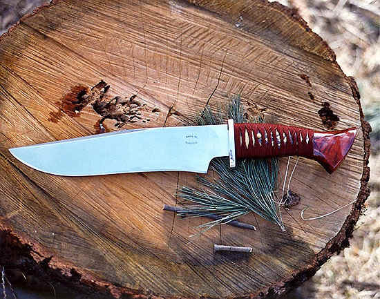

Some makers choose 1095 because it is such a good steel for blades
Shiva Ki makes awesome blade in 1095
