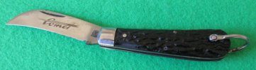

I might have got the wrong end of the stick, but if we're talking about a blade 'drooping', what we're talking about is blade cant. Underblading/Overblading is a slightly different thing. Underblading is where the spine of the blade sits fractionally lower than the back of the spring, and can be a deliberate design, the purpose of it being to prevent 'overblading', where due to wear, the blade rises. I had a long discussion about this with Stan Shaw after a request by Mr @JDWARE , and I think part of that discussion will be here - somewhere! o_O :thumbsup:
I also have a few examples of a deliberately overbladed pruning knife, but it's a very unusual knife :thumbsup:
