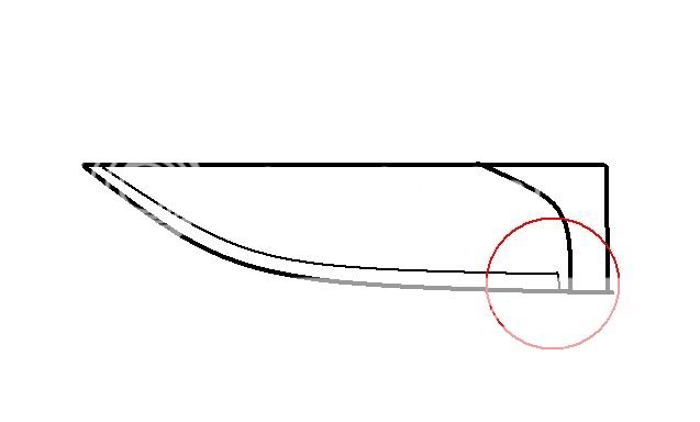

What I hate more is seeing something like this on a custom knife of any type. I've seen this on some super nice knives too.
There's a nice mirror polished hollow ground blade with a neat sculpted plunge line....that is interrupted horribly by an incomplete, ugly, fat edge bevel.
if the plunge line is radiussed (in the axis we can't see from the illustration), and the bevels are constant (not twisted) then this will always be a problem. We can eliminate it by varying the geometry of both bevels, reduce the problem by having a very thin edge, or just not radius the plunge (squared edge termination when looking at the blade edge on).

well the problem is in the plug line .if you don't put a relief in this area like a half moon or some thing .when sharping on a belt you will remove more of the blade then at the plug line area and then you will end up with a dip in the blades edge and that looks very bad. so thy blend in this area to keep the over all profile right. so to fix this you need to grind this area very thin and it will be easier to sharpen. or make the knife where the blade drops below the choil/ricasso area so the cut area is easy to sharpen. tommy

To be brutally honest, I think it's because many guys get more and more nervous the thinner their grind gets... add onto that, they worry about matching their plunges... and they end up leaving the area near the plunge too thick. This is pretty common actually. I know I used to do it when I wasn't very confident with my grinding! :o
It's "easier" to avoid if you're working with a dropped edge or a choil cut-out... but even with no dropped edge, and no choil notch, a good grind will be uniform top to bottom.
This is also why I feel it's impressive when you see a maker has perfectly matched plunges as well as a uniform and THIN edge.
Even though perfect plunges are the mark of a good maker.... if the edge is thick and not uniform... it will not be good at.... wait.... what is it again???? Oh yea!!! CUTTING stuff. ;) :)
I agree with what's been said here. A lot of makers leave the edge too thick at the plunge and many are too thick all along the edge. This makes it very hard to sharpen and looks like hell... First thing I notice on a quality knife, is a super thin and even edge.

A radius in the plunge must be accepted in some circles because there are some pretty well established makers using it. If the radius in the plunge is large it is not possible to grind the terminal edge all the way to the ricasso, it makes the grind line at the ricasso sweep up toward the spine of the knife. I personally try to keep that radius very small and grind the edge all the way to the ricasso.
Don, how thick would you say the edge should be? I have been using a 24 inch hollow grind because I like the effect but with a shallow hollow grind it is easy to make the edge too thin.
