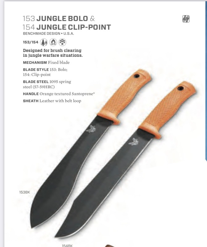

As others said, it depends a lot on heat treat. According to BM, these 1095 blades are hardened to 57-59 hrc and are designed for chopping.
