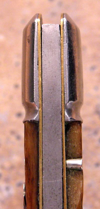

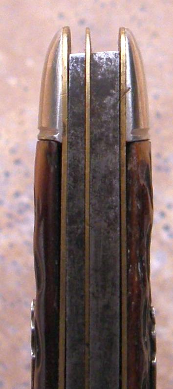

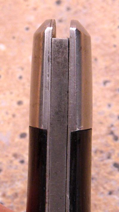

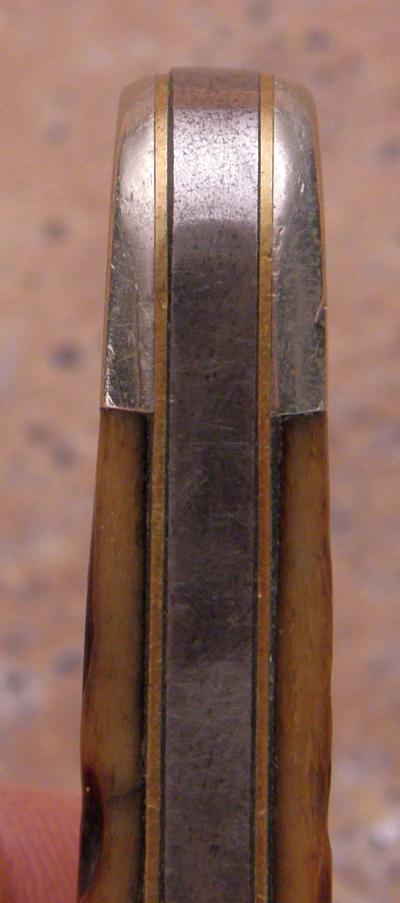

Dovetaling seems to be a fairly modern trend in custom knives.
Here are 3 examples of old knives that have the very subtle "reverse dovetail" joints on the cover joints...OVB Equal End Jack, Hammer Brand Beaver Tail, and a NYKCo Coke Bottle.
One of the reasons that zerogee didn't touch on for fitting covers this way is that it's easier. In the production environment, it's going to be easier to fit handle material on a bolster that is shaped this way.
No tater chip lookin covers on these old knives.
