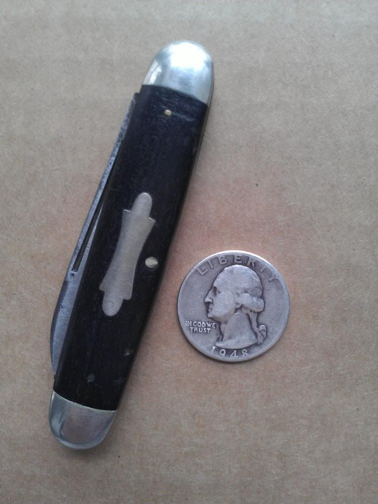

Why Ebony?
One more shot of the White Owl. I probably should have kept this one.
I have persimmon trees on the farm. Over the years I have cut a few of these up and found a couple of things about them, one being that it is akin to sawing steel with a chainsaw and it has small voids in it. This could be from whatever killed it but seems to be a common trait. I have tried unsuccessfully to finish a piece or two over the years. Interesting colors, yellows and greens but not much visible grain structure. I thought about cutting down a healthy one but never could bring myself to do it as I really like the fruit and we do not have that many.
Thanks for sharing this, that's some interesting information. Don't have any near me, only get the fruit in the supermarket.
Ebony feels great in hand and wears well. My first ebony. The first of many more.
I like the striped stuff on fixed blades with larger handles like Big Mike showed, but the pure black on smaller folders.

Ebony still looks good when you see an older knife that has been through the wars ( in age-Literally ) and it carries the scars, you will see the fit and finish still spectacular to its Nickel Silver Bolster,.
It feels like velvet yet hard like steel. Something about Ebony,Nickle bolsters and carbon steel; Their hues compliment one another.
These guys say it better than I can. The fact that it's been used on knives for over 100 years also appeals to me.
