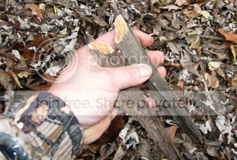

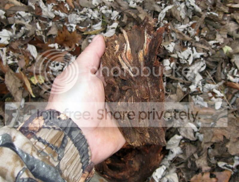

Since I am doing this primarily for the benefit of the new guys here, perhaps a little back ground on how fatwood looks in it's natural state would be appropriate. For the most part fatwood will look like just another piece of rotten wood in the forest. It will either be a solid core surrounded by the decaying softer outer layer that is just rotten wood, or it will sometimes be weathered and grey pieces of litter laying on the forest floor. It is the weight, density, appearance and smell of the solid core that will give it away. It will be heavier than you expect it to be from its rotten appearance, harder to break, the inside will be glossy and shiny and it will smell like turpentine.

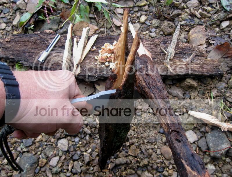

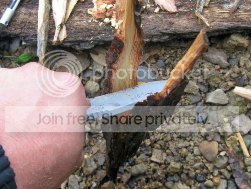

Once you've found it, just split it like any other wood you'd be using for kindling. Even if the outside is soaking wet if it is good rich fatwood that will be of no consequence.

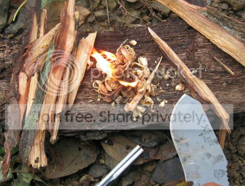

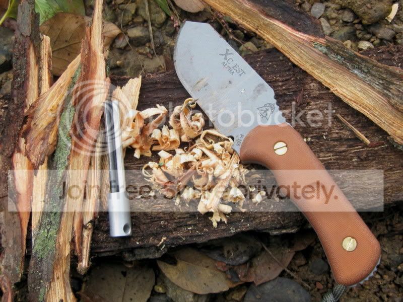

Take one of the smaller pieces and whittle thin shavings just like making any other fuzzies
and then light it with a match or lighter, or spark it to life with a ferro rod and once burning good add the smaller slivers.
Hopefully this little video will demonstrate just how well it will work in wet conditions. Also...had this been magnesium shavings I was working with there would have been a point where I had to start all over...I'm sure you'll have no trouble spotting that point.

What was the mischmetal rod you used?

That is a TOPS fire starter, combination of two magnesium rods and one ferro rod press-fit into an aluminum cap collar.
Under dry conditions I'll usually scrape a fuzz to go with the slivers and use a mix for tinder. In light rains I tend to just go with slivers...it's quicker and the fuzz sometimes will get water logged in a rain. That was my first experience with that particular ferro rod....throws great sparks though.
