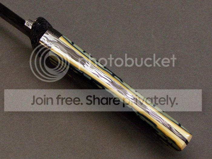

Thanks Darcy. I'm sure others have done tapered frames, but it would have to be very few. I can't recall any.
OK, dig this... a tapered faux-integral frame.
It actually worked out well, for a crazy idea.

Tapered frames?.?.
How about a tapered frame with an integral bolster? (My latest... I still have to take final photos of this knife.)
And here's my very first frame... also tapered.
The only non-tapered frame that I've ever done was built with thin G10 on a thin tang. A non-tapered frame might also be necessary if a builder was planning a threaded through-tang.
