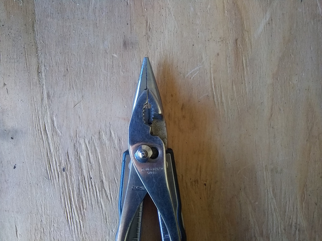

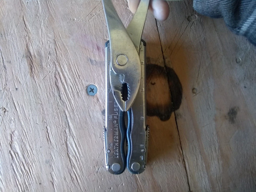

All I'm thinking is a small slip joint so you can grab a slightly larger object or at least have a more parallel grip on a slightly larger object.
I get your point about them not closing right when in the second position , but at least for me and I suspect a lot of people i instinctively slide my slipjoints back when I put them away.
The SpydeRench illustrates some of the problems involved in your "simple task" of adapting slip joint pliers to a multitool. In the small grip position the handles are too far apart to stow easily, in the large grip position the plier jaws are wide enough to cause issues.
I understand the potential issue, but you have to look look at a regular pair of slipjoint pliers and not at the only other previous attempt which was implemented on something kind of gimmicky.

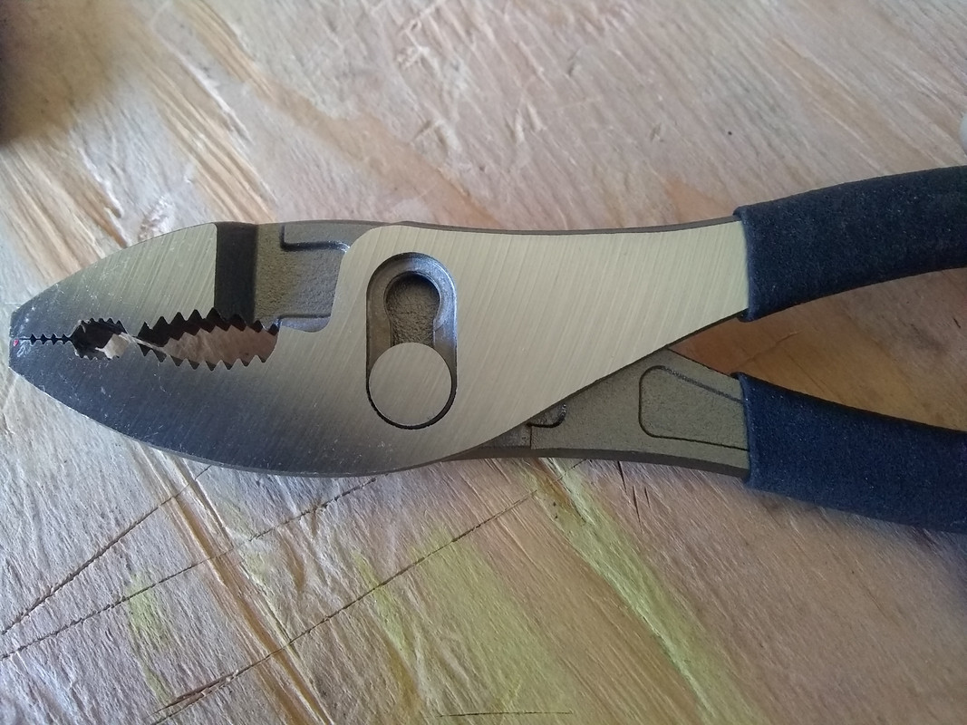

You can see here these old 5.5" slipjoints aren't much bigger than my leatherman fuse, and the handles aren't any wider.
They're only about 2mm or so thicker too, if they used an inset flush joint like these Craftsman 45379 they could fit a set of slipjoint jaws no problem.
I say someone could make this work no problem.
