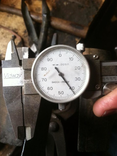

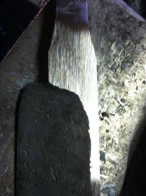

For me the part I enjoy the most about knife making is forging the blade. I would guess that most that forge agree. I see alot of bladesmiths just forging a rudementary shape, then stopping to grind the rest. Not sure why this is, and not really knocking them, just wanting to say that forging closer is much more rewarding for me.
Here is a Bowie from a few months back-
This photo is straight off the Anvil, NO grinding has been done-
This photo is after ricasso/profile clean up-
And the last pic of edge thickness as forged, this is before any grinding-

That's awesome. Haven't been able to forge that close for the same reasons Nick said, but that's nice work!
Is there a strength benefit to forging the bevels and edge thickness down that closely (rather than grinding from full thickness)? It looks great, I'm just curious.
Skilled forging on the bowie.:thumbup: When the forging is taken to this degree, the forging itself becomes more refined. The bevels have to be centered the spine straight and the ricasso flat. Its not easy getting them all to align.

Is there a limit to how fine you can forge and not have issues with decarb?

thanks for the kind words, I use a #50 Little Giant, then shift to a #3 English style hammer made by Jim Joyce. I have a Tai hammer but havent heat treated it yet. I forge them all just about like this as far as "close" some edges Dont get quite as thin, but close. As far as adding strength etc., there is an argument to be made for grain flow/structure etc. BUT thats not the intent of the post, I just like to forge as near to final shape as I can and wanted to show an example. There is an occasional blade that I cant get all the pitting out of, generaly those will get a belt or blasted finish. Whats also fun, and ive done it a few times, is going right from the anvil to heat treat, to sharpening without ever touching a grinder.
