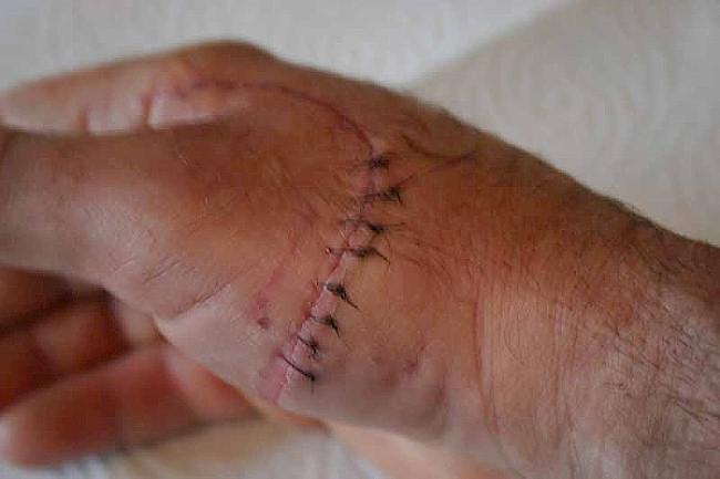

I was buffing a light bezel for a car I'm restoring but it just as easily could have been a knife.
It took eight stitches outside and 4 inside. I severed a tendon in my thumb and should have it repaired on tuesday. I very easily could have lost the whole thumb.
This is a good reason to ban the use of buffers in the shop. Be safe people.

Bladsmth my hand was not through the ring. I was holding it just as you described. I went through my normal routine of doing the job in my mind before I even stepped up to the buffer. I attempted to foresee any potential problem areas and addressed them mentally and then went through the act of buffing the item. My best guess is a thread from the buff grabbed a small tab attatched to the ring, carried it around the wheel and into my hand. I do not have an instant replay to confirm this though but trust me I am not about to put my hand through anything.

BTW, this thread is worthless without pics. :D
edited to add reminder picture
