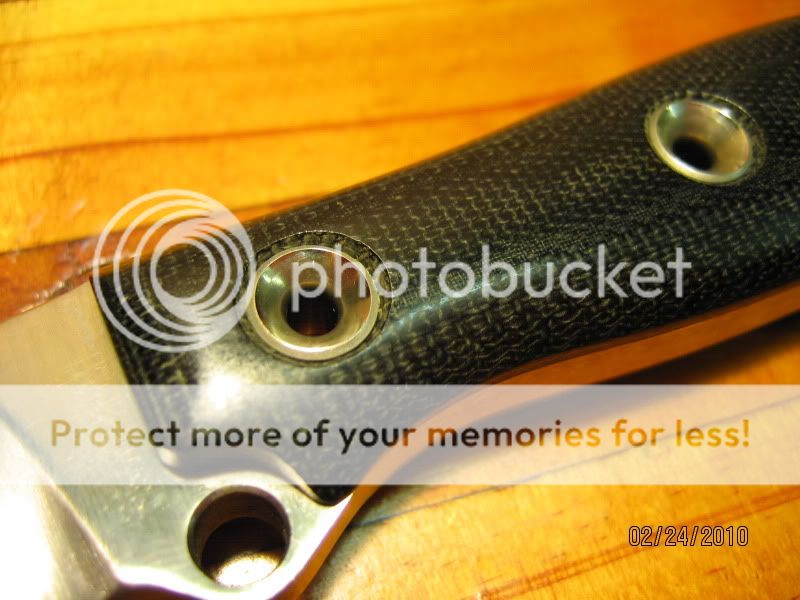

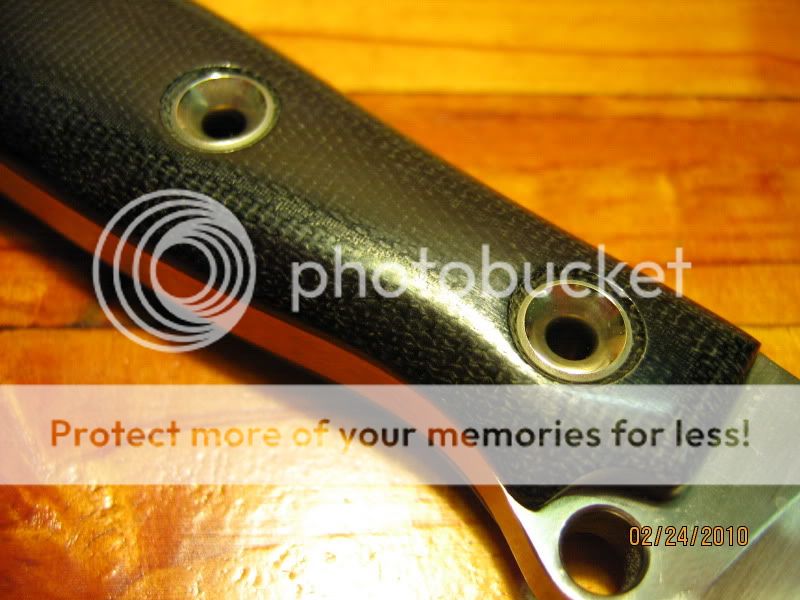

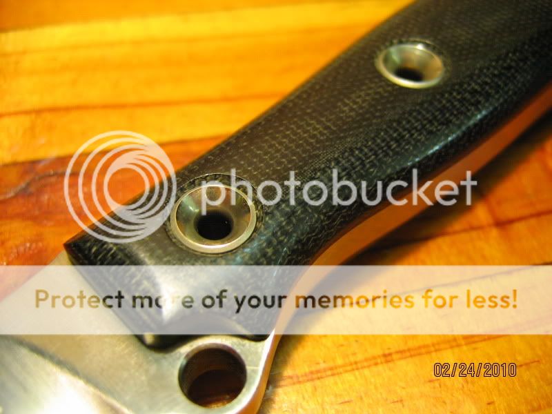

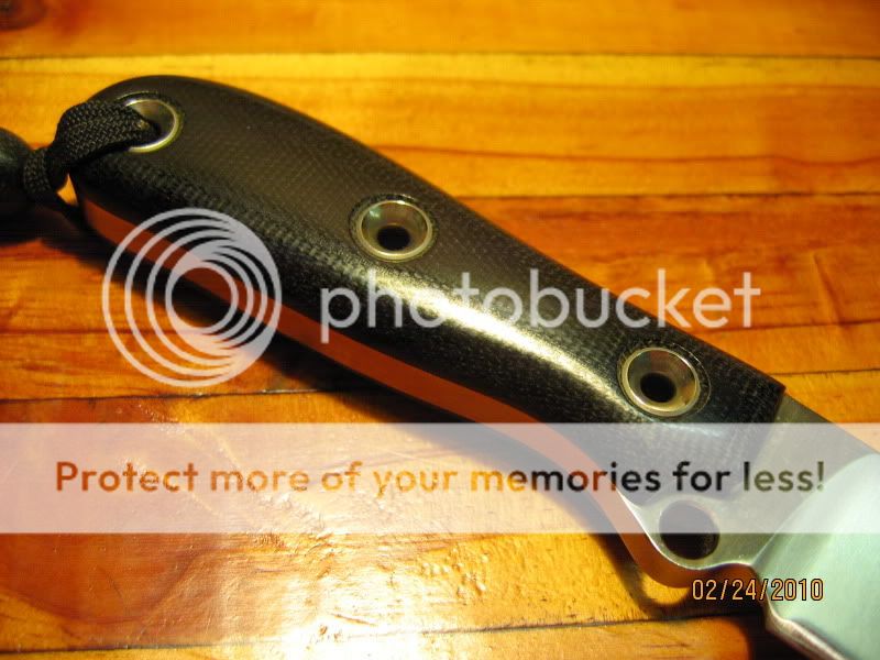

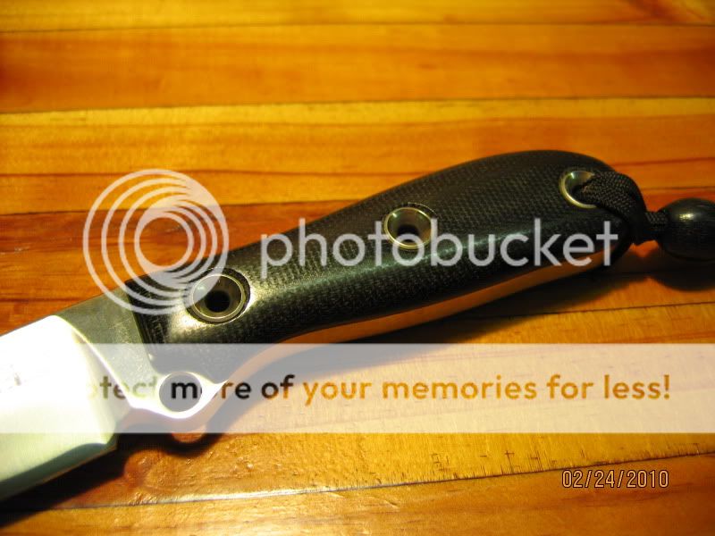

Black Canvas Micarta takes on an almost translucent sheen when polished up after using a very fine grit sandpaper. Still not as black as Black G-10, but very nice IMHO. This is a Fat Warden I rehandled some time ago. The last pic was taken with a flash to try and show up some of the translucency.

I've noticed that too, I've been taking to sanding my black Micarta handles with 600 grit sandpaper, then 1500, and finally 2000. it never gets black like the g-10, but the way it ends up, kinda reminds me of a pair of black jeans that have been lacquered.
I think someone said to use black shoe polish, but I think that just turns EVERYTHING black. If you use neutral polish it really brings out the depth of the black. You just have to try it to see what I'm talking about.
