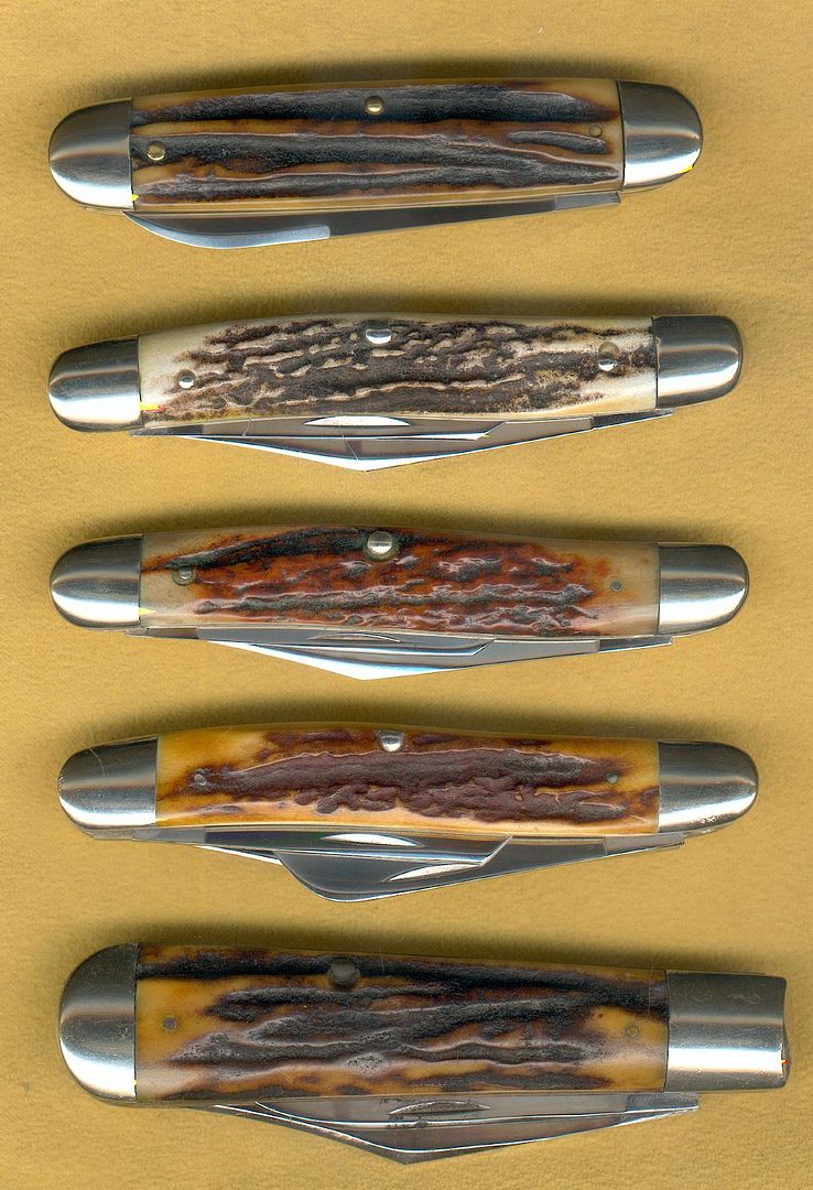

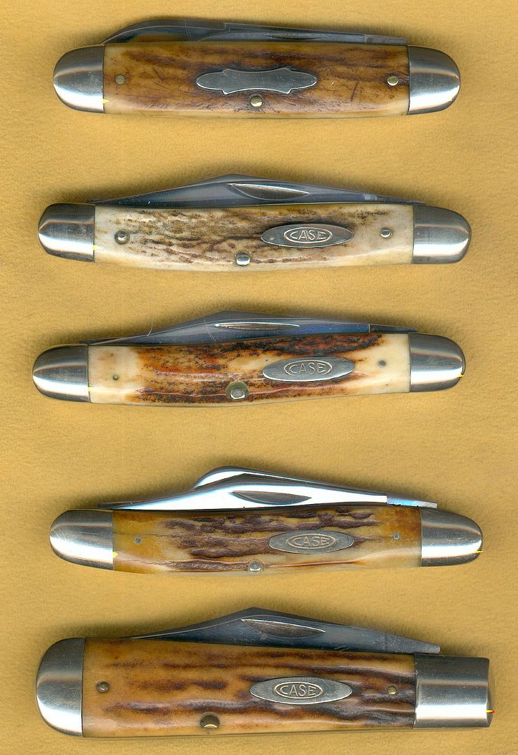

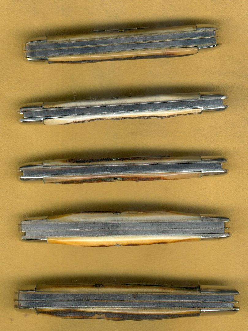

I don't have many Stags, and I am hoping some of you can give me examples of this phenomenon. I do have these five knives as examples. In each one, the Mark/shield side is much smoother and flatter than the pile side. Can anyone show me more, and hopefully older examples?
The top knife in each picture is a Schrade Cut Co, the next 3 are Case '47 patterns from the '50s to 1970. The last is a Case XX 5299 1/2.
Thanks!!
Mark sides;
Backsprings;
Pile sides;

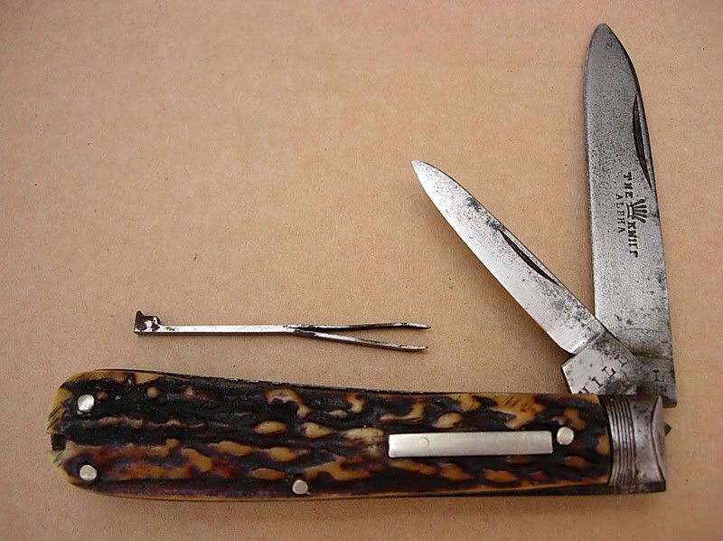

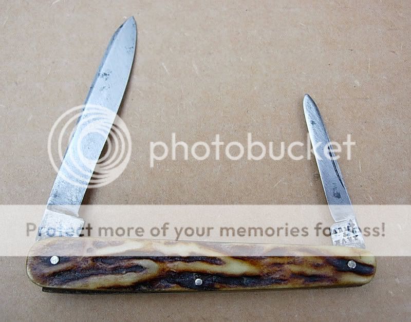

gbuskirk, Bernie Levine once noted the gnarly piece was under the fingertips, for grip, but that was on several pruning knives, which are usually held blade in toward you.
We may never find it in writing anywhere, that is why I was hoping to see more examples. I think it is only significant with older knives though, 50 years and more.

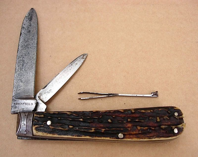

my 2 stag knives are odd. 1 is a Case where the pile side is less gnarly than the mark side, the other is a GEC/NF is where the pile side is gnarlier... so much so that it feels like a chunk of the handle is missing or broken off.

Rick T, your knife verifies Bernie's comment; a working knife, which may have been intended for "pull" or "pinch" type cutting (note the curved handle), would have the gnarlier piece under the fingertips for grip. The curved handle is best suited for that type of cutting, hence pruning knives have curved handles, which fortuitously, also accommodate curved blades!

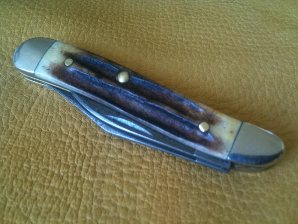

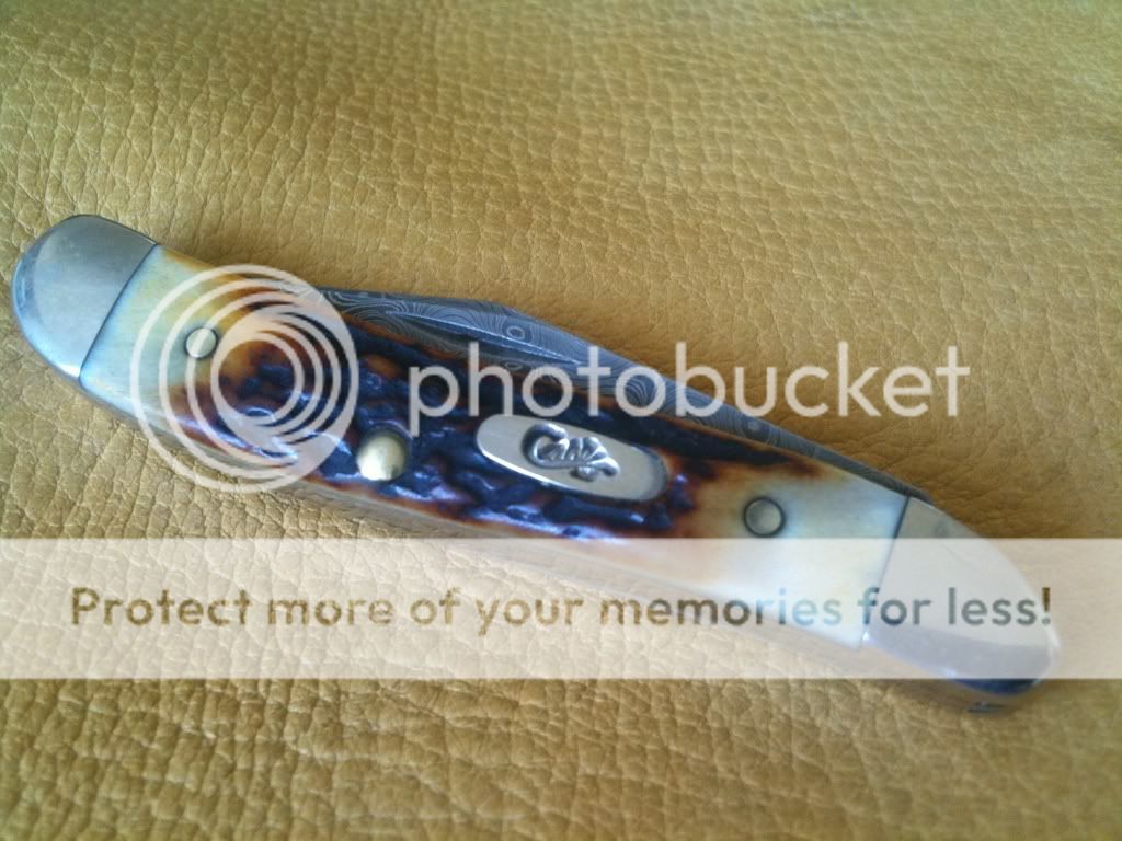

Here is my Case Stag Damascus Peanut. Its not old, but I think it shows a similar scale difference, smooth mark, rough pile side

yes, and I like where you are going.. the pattern Im noticing is that the pile stag is deep canyon, and the mark stag is smoother. Another pattern I see is that the mark side is thicker than the pile side, both on your old knives, and on my newer one. This all makes sense in terms of selecting a shield friendly scale.

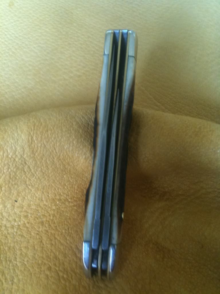

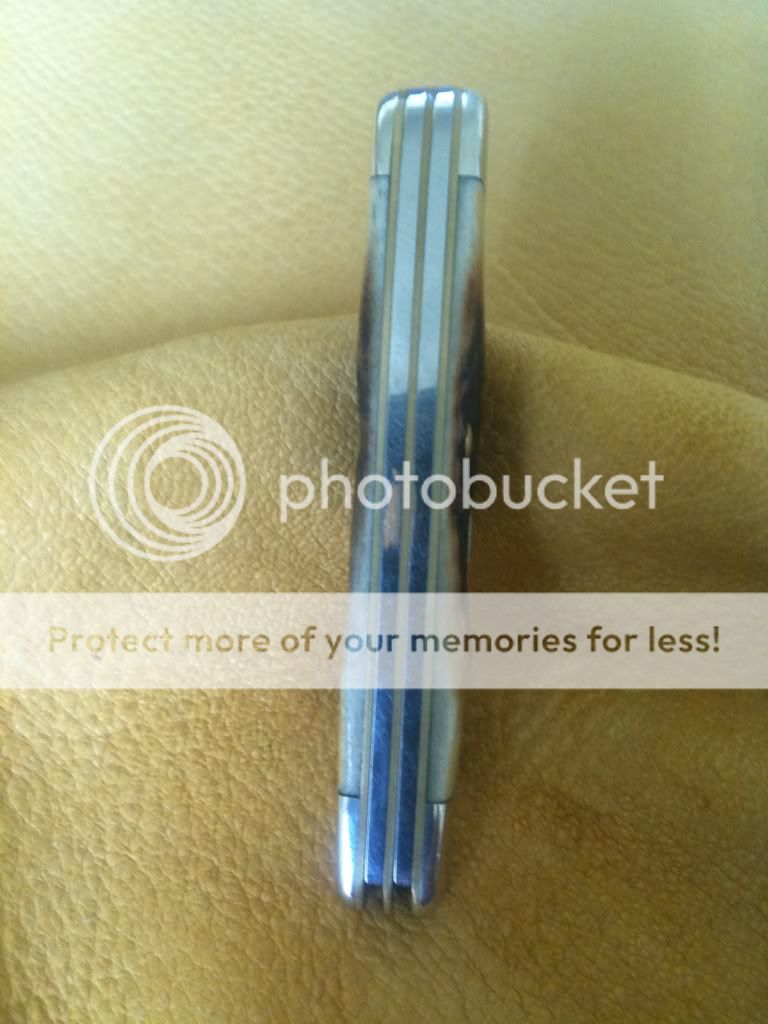

I recently picked up a second stag damascus peanut
the top one is the first one, the bottom one is the second one
I tried to show the difference in patina darkening of the damascus. The blades on the left are the second peanut, the new one. Its hard to show, but yes, the damascus does get a little darker with time and use.
