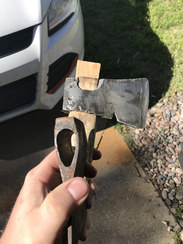

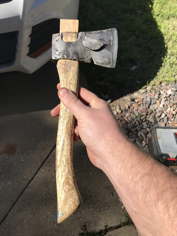

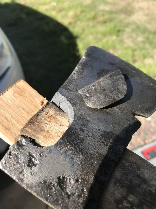

So every now and then I get these little china hatchets when I buy a lot of tools. I have had five or six laying around for a while. I put one on a little 4” handle and let my daughters play with it (with my supervision). Then I got another one but the handle was perfect. So I thought the girls would want a longer handle since they have gotten used to it. I went to wedge it and bam! This head was actually hardened completely. The grain of the casting is also super wide! Just thought I’d share!
Also, surprisingly enough the handle is perfect. Very slim and large swell. I’d love to use it on another hatchet but the eyes on these are so small idk if I can find one that will fit right.

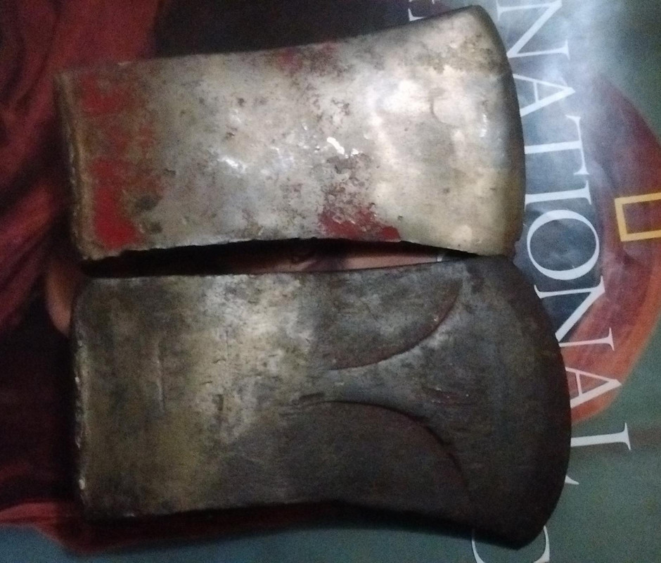

There is more to this than meets the CRACKED eye. Legitimus Frankensteinus screams: But my cutting edge is perfect !!! :)
Some people mentioned woodslashers with hairline cracks around eye. Lucky me: I got one too :)

Brian,thanks for posting those photos of the broken eye.
You're very much correct in that the grain-size in the fracture is obviously excessively enlarged(as a rule of thumb one must not be able to distinguish the individual grains).
However,your conclusion on the Hardness of that are being excessive may,or again,may Not,be right.
Personally,i'd say that there's a good chance you're right,however,without actually testing(specifically with a Rockwell tester or an analog method),we CAN'T say that,as grain enlargement does not just automatically equal excessive hardness.
