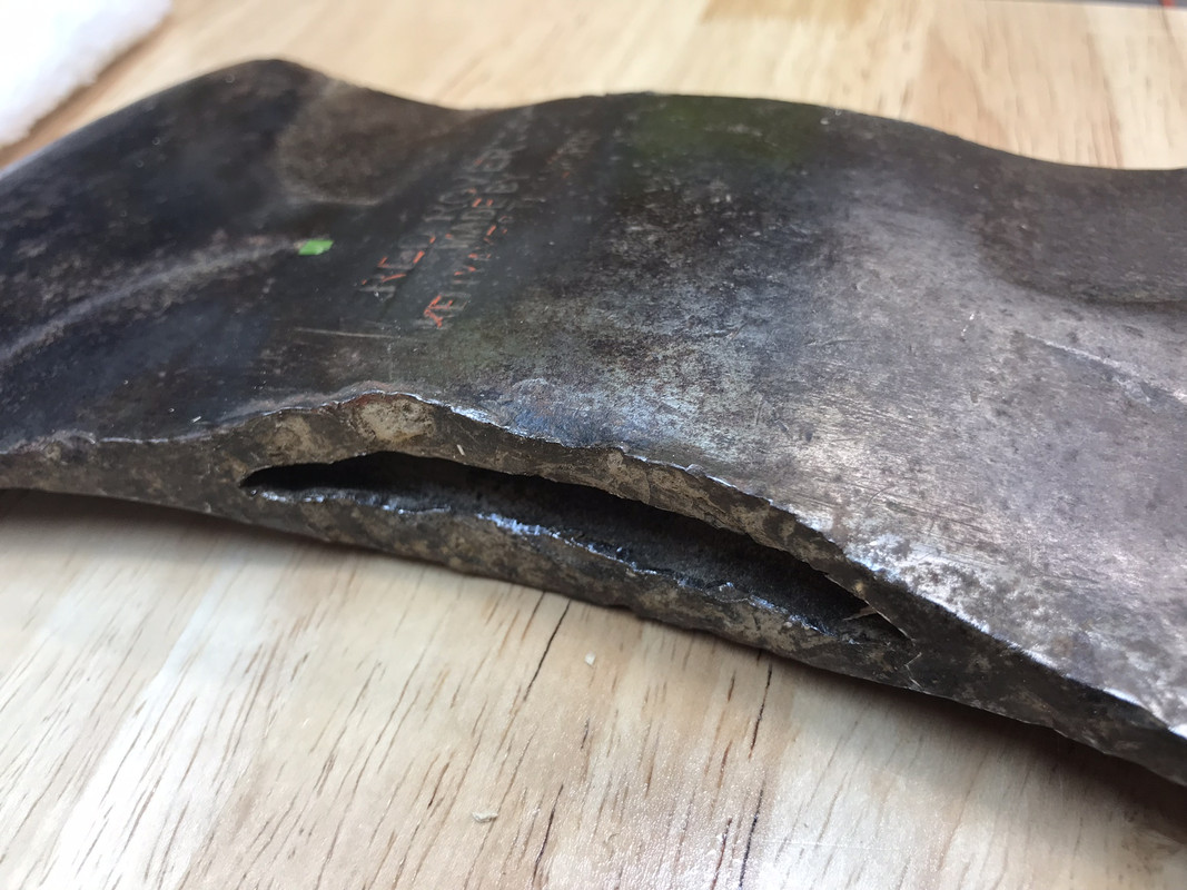

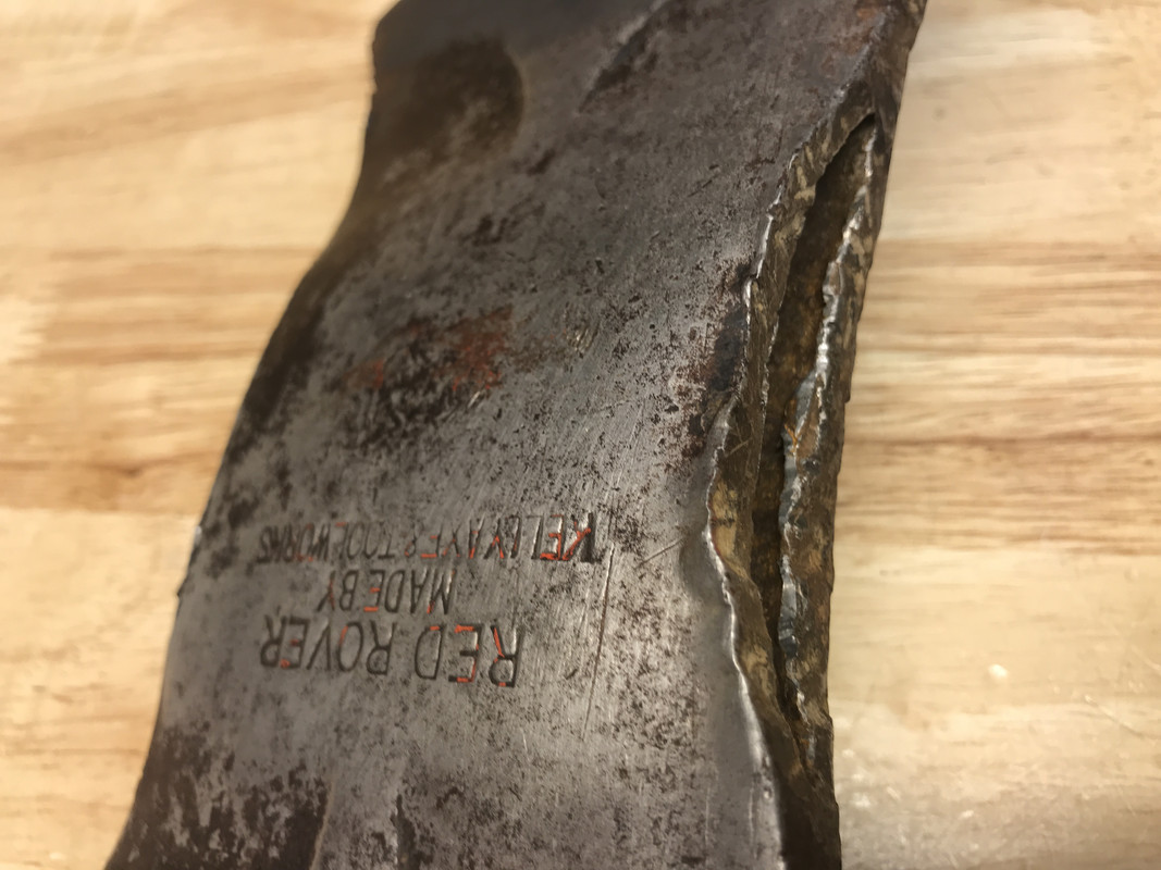

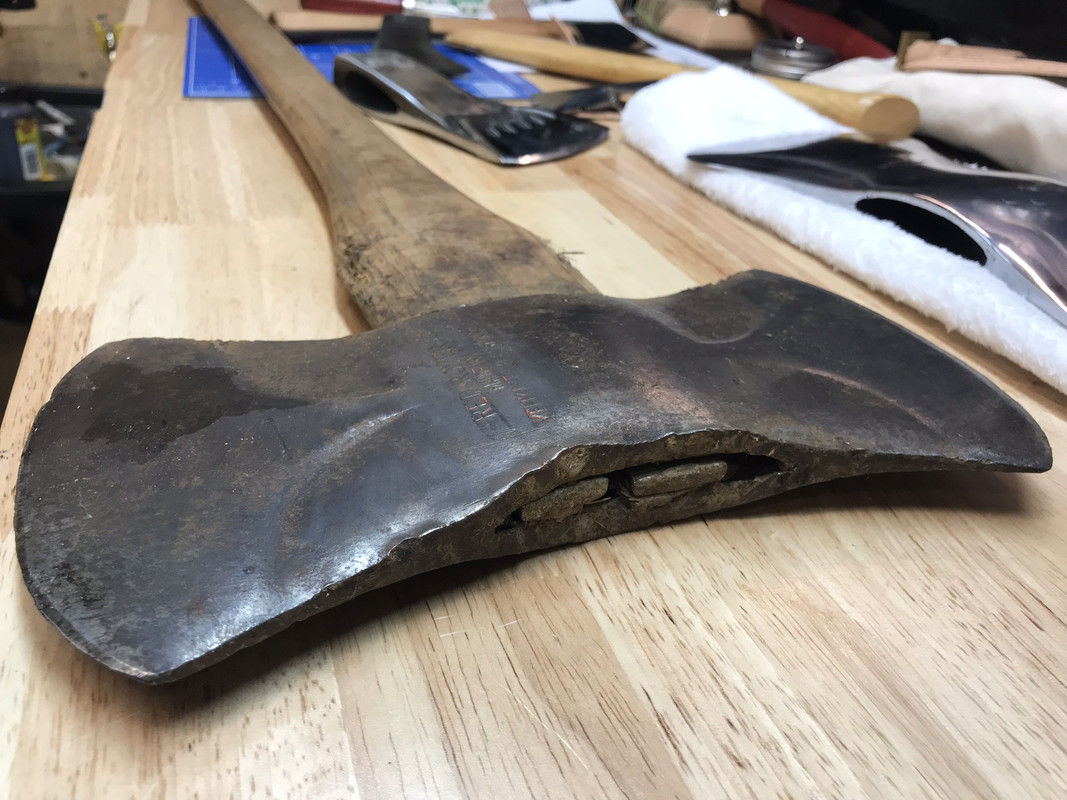

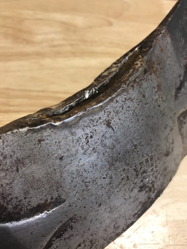

Talk about smashing the top of the eye!?! Check out what some genius did here...
they only fit the handle halfway into the eye and were too lazy or stupid to do anything other than try to hammer it on. And then they frickin’ tried to hammer wedges down into the eye deep enough to spread the kerf. But the handle was still only halfway into the eye so the just battered down the eye trying to get the wedges in.
This is why I’m a misanthropist.
That's a damn shame... However due to the pattern that is totally salvageable!
I know people are so stupid. You'd think they would see all the damage they are causing and would take a minute to figure out what they're doing wrong... nope!! Fing people..

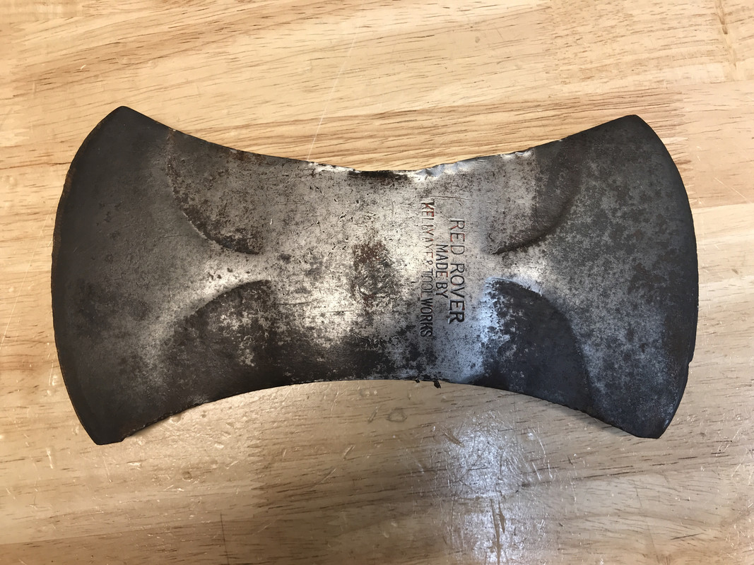

I would not have usually bought this, but it was a 5 3/4 lb Kelly Flint Edge Hand Forged double bit. Got the same treatment along the line somewhere.
Wow that is a unique one... I'd have grabbed it too! Rare to find one so heavy and stamped thus with the weight.
What does it weigh now? And will you restore it soon? I'd love to see some photos of the process if so!!

I see what happened here. They put the wedges in and then smashed the eye down to hold the wedges in. It makes perfect sense. Are you going to be able to save her? It's still in pretty good shape other than the obvious. Nice looking axe!
It’s salvageable for sure. You can cut off those mushroom ridges on the eye and profile the top and bottom a little so they match again.
But at this point someone else has big plans for it, it was part of a trade I just negotiated. And now I am made to suffer as I learn how old and rare it is.:(
