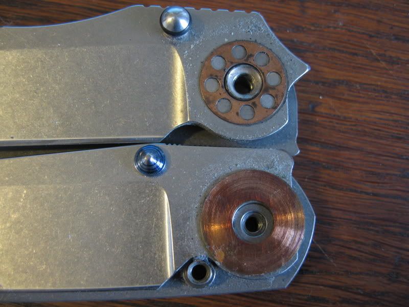

The holes in the washers sound like a general improvement that could and should be applied to all CRK folders. Who doesn't want less friction and better oil retention in their pivot area?
This thread is not about knife versus knife, it's about why such an obvious improvement is not being applied to the Sebenza as well?

Are the bushing diameters so different that they can not be used on the sebbie's? in the pic they appear to be the same size.
I knew someone was going to ask that, curses!:D I was in a hurry and too lazy to get the micrometer out when I had them apart:o The Sebenza appeared to be larger in diameter and thickness though. I will check for sure.

Many of the features unique to the Umnumzaan are more for me (CRK employee) than for you (customer). For instance:
Double T-lugs and swedge are standard and either integrated in the handle or designed to be easy to produce; no more special order headaches for me.
The heattreat on the locks on our other folders is a pain to produce and has to be protected through subsequent processes; the detent ball on the umnumzaan solved that.
This feature is also for you guys since we're hoping that ball will fail less often than the heatreat on the locks.
There is no pivot bushing that needs to be machined, measured, sorted, matched and adjusted.
The Reeves are pretty conservative. Chris probably won't mess up proven designs with experimental ideas until he's had a chance to see them in action in the umnumzaan.
The fact that the umnumzaan is a heavier knife will help that evaluation. If these new features can stand up to a heavy knife they'll do great in a small seb.
