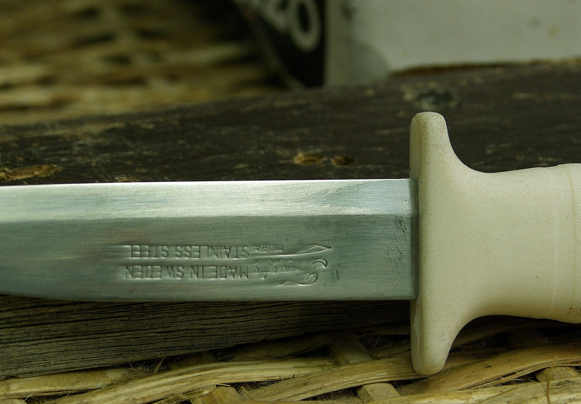

+ After 20+ years of ceramic , it was a micro bevel . And the knife does not look like it has had 20+ years or more of use .

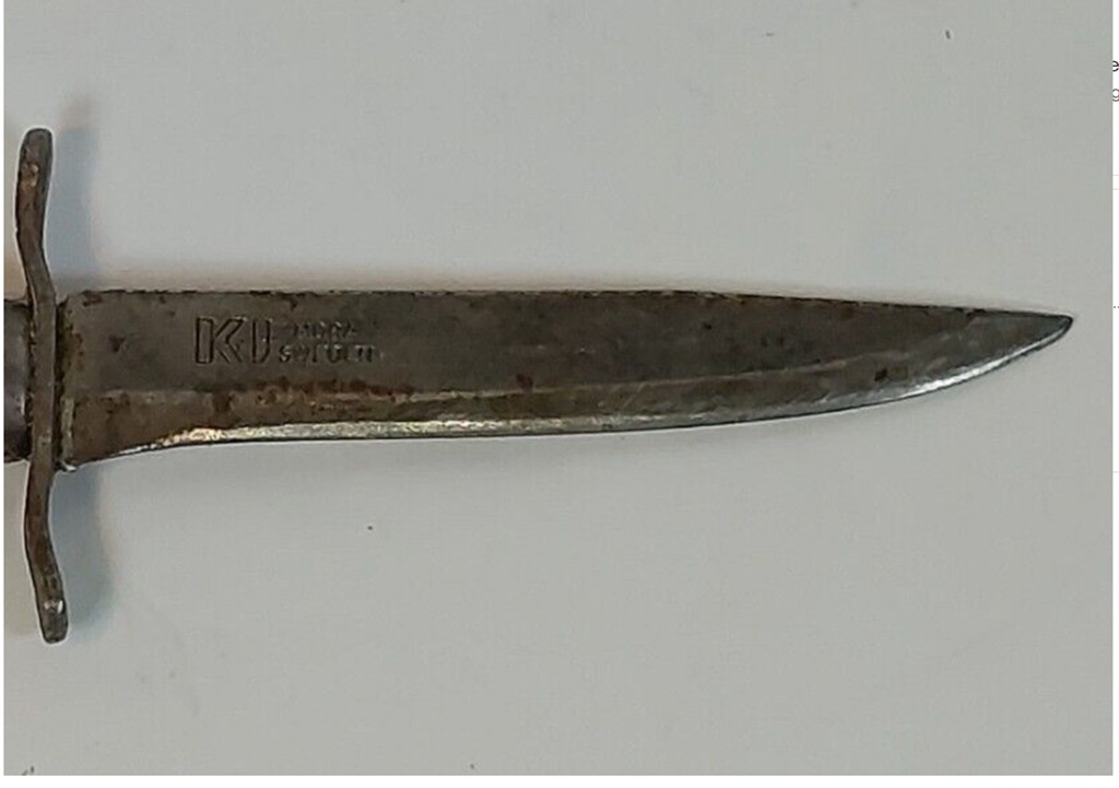

My first Mora ( Carbon ) , brought over from Sweden by my Aunt .. 1977/8 I was in Highschool back then . It be 2023 now .. For at least 12 years the knife has had no use due to the influx of Chinese knives . ( Into my collection of knives )
My second Mora ( Frosts ) , stainless .. Brought over from Sweden by my uncle .. ? 81 to 83 ( I dont remember exactly any more ) ..
By 85 this was my go to knife for stuff that stains a lot .. This knife went where I went till around 2009 ..
So 24 years of use (?) , there about . Sharpened with a very fine ceramic rod I got in the early 80's from a cutlery store .
So , a very micro micro bevel on it . The carbon knife was used at home for non staining duty till the age of Chinese imports . ( When I started )
So again quite a lot of use .
Neither knife has significant wear from many decades of use .. And ceramic sharpening !

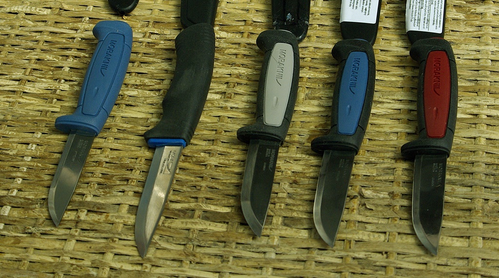

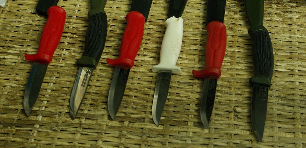

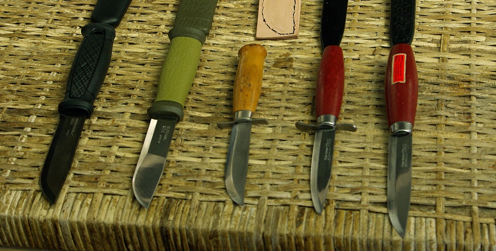

I only have 16 Mora's ...........
At one point I might have succumbed to the Mad Mora collector gene and gotten a bit out of control, in part because they weren't very expensive. I have a couple more that aren't in that photo and a couple more that I'll probably get some day in the not too distant future.
Only a few were purchased as collector knives ..

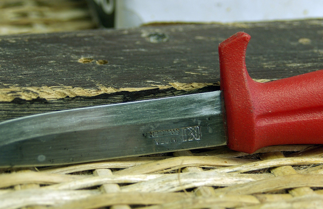

Picture 1 ( Top )

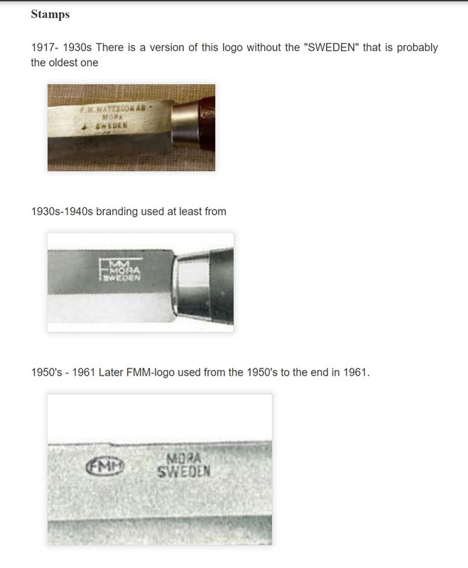

Garberg / Mora 2000 / Possibly 100 year old Mora By tang stamp / and two more wood red handled .. The far right being a 70's Laminated . & The possibly 100 year old one looks to be laminated as well .
The old one is at least 91 years old to maybe 108 or so years old ( ? ) . Time period for tang stamp . I own most Mora's out of curiosity .
There are far more interesting Mora's out there for collecting . If you have deep enough pockets ! That old Mora , was a happy accident ! I was really after the 70's Mora Laminated ( Always wanted one ) and the old one was part of the package .
I thought it a junk knife till I researched the tang stamp and cleaned up the knife . It actually looks to have never been used . The sheath was so crusty , it literally fell apart . ( A shame ) ..
When I got the knives in the mail , I thought the sheath looked to be 100 years old .... I never imagined I might be right .
