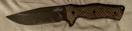

I've heard the arguments before but I'd be interested if something new has emerged to the question: Why strip the factory surface finish off of a carbon steel blade? What is the function of removing the finish that serves to prevent the blade from rusting? Is this purely a asthetic act? Is there some fear of movement of the components of the surface finish into food? What if the blade is quite obviously not going to be used for food prep, like, say a Becker BK-9? Interested in your responses to this in advance and thanks for your input.

F FIUman The coatings of my BK-15, Carbon V SRK, and Mk 1 USN got in the way of my thinning the edges on those knives. I also like to see the patina on carbon steel.

I don't MIND a coating, but it's there to protect the knife from something that I will protect it from anyway. Mitigating rust can be done other ways than by painting it. A lot of time i'll leave it until it starts to wear unevenly or i find that i am having to coat 1/3 of the blade in order to protect it from what is gone. Then it gets stripped, patinaed, and used some more.
I tend to thin and refine my blades, so the coating would have to be removed first. Plus most coatings chip off. It’s not hard to keep a blade from rusting. The edge isn’t coated so you have to keep it from rusting anyway.
Usually I find coatings hide poorly finished blades. Manufacturers know they can skip surface finishing. I try to avoid coated blades.
Avoid coated blades if you dont like them and go for more permanent finished like stonewash or satin. I dont like bead blasted due to the higher tendency to collect moisture in the divots caused by the blades and a stainless knife can/will start "chicken poxing"
If thats the knife you want and it has a finish, unless you know what youre doing I wouldn't, also make sure the knife comes from a maker with integrity so you won't have to worry about concealed poor blade finishes as mentioned above. Just my .02

A rougher surface beneath paint is more than just cost cutting. The rougher surface serves to increase paint adhesion. Just like you scuff-sand a metal down spout before painting it with house paint. It increases the surface area and provides nooks and crannies the coating can mechanically lock into. Organic coatings do not have a great affinity for metals, so you need to give them all the help you can.
