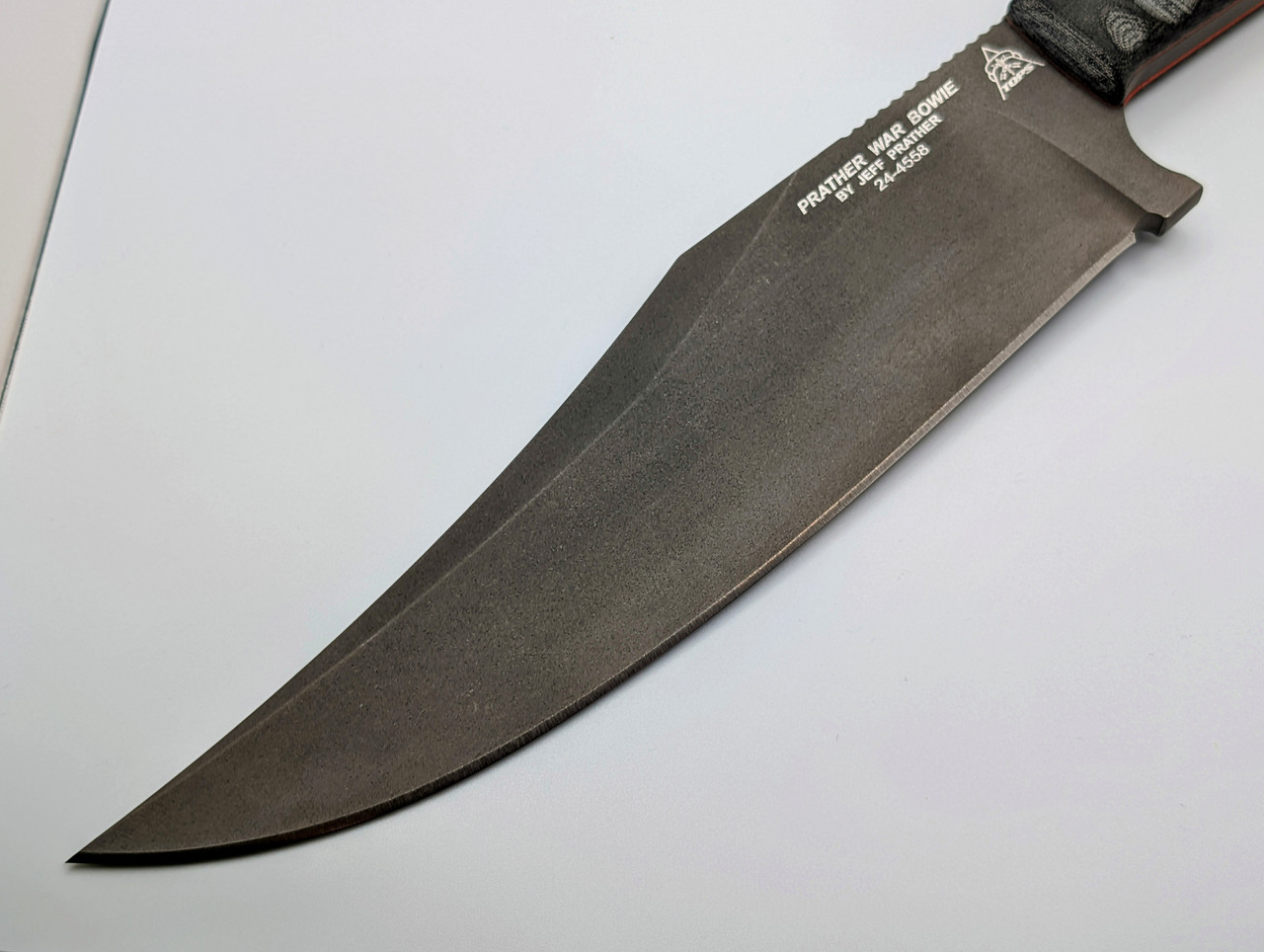

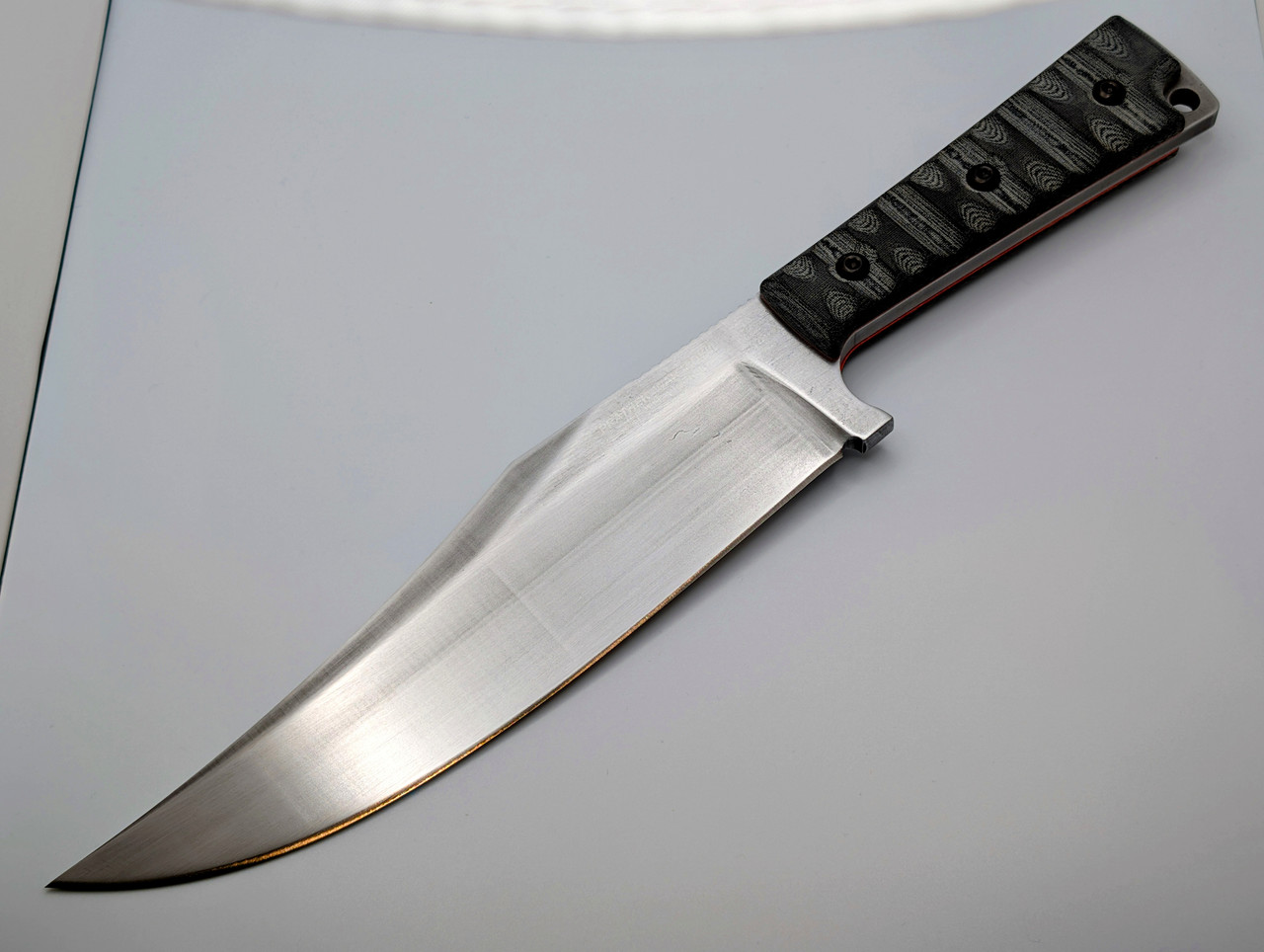

After trying acetone, which didn't work at all, I stripped the epoxy coating off my Kabar Mark1 deck knife using methyl chloride paint remover. (Note of caution: this is nasty stuff – only use in an open well-ventilated space and wear rubber gloves.) I wrapped the blade in a scrap of old towel soaked with the remover, stuck it in a plastic bag and let it sit a half an hour. Voila! That softened the paint sufficiently so I could scrape it off, although it took a bit of work.
Black blades are cool, but I don't like the rough epoxy or baked finishes - reasons already listed - more friction and not food safe. Sometimes the only option is coated and I really like this knife!

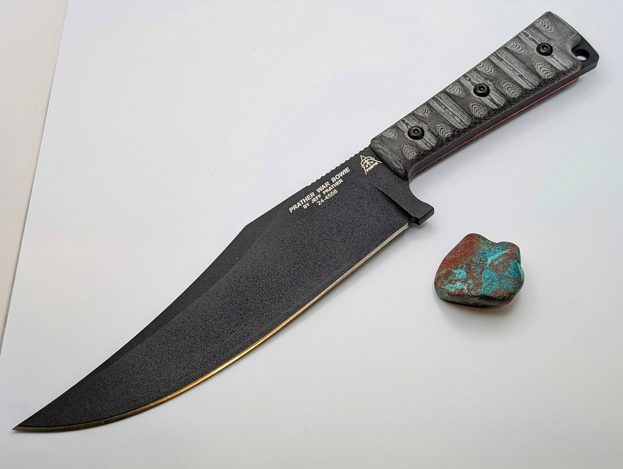

Before
Sandblasted surface after coating was stripped with acetone.
After sanding the blade smooth

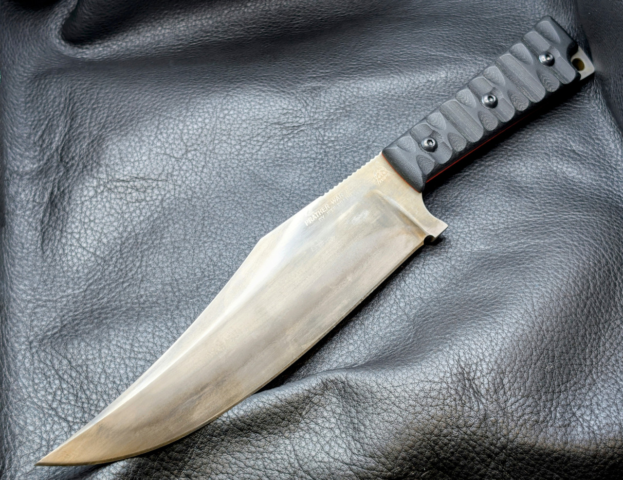

Vinegar patina - helps with rust and I love patina

After the epoxy coating was gone, I learned to hand sand & got a lot of practice!
In the end it came out great.
