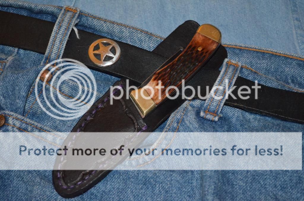

By the way, this is a rig I recently made for a buddy of mine
Sheath holds a fire starter (ferro with scraper) and sharpening stone, and the drop loop houses altoids tin. And there's a whole bunch of holes for attaching paracord.
Now that is a nifty sheath set up, pretty smart utilizing the dangler loop for the tin holder. :)
