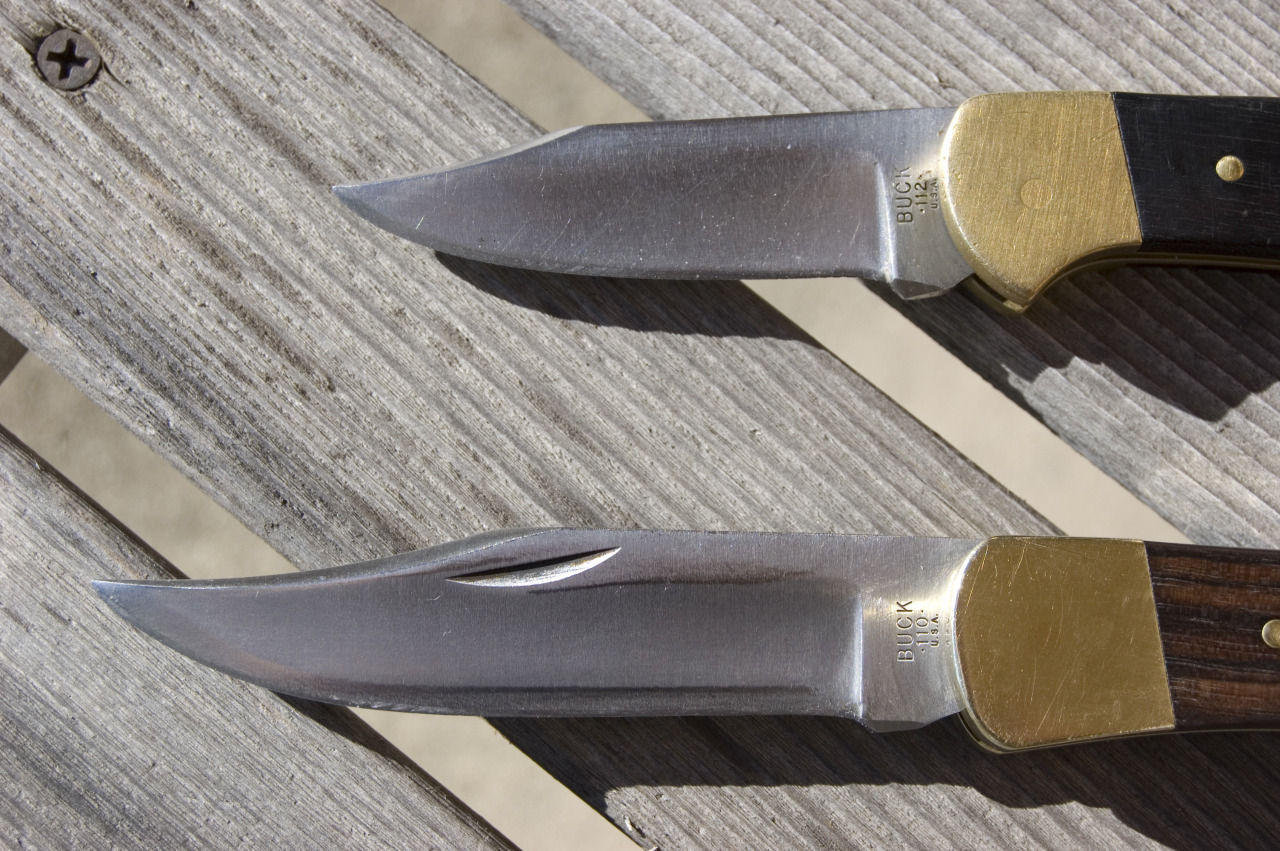

Interesting question, Pinnah. I have a 112 and 110, both two-dots. The 112 appears (and feels) to have a straight "single hollow" hollow grind — it was also reprofiled by some previous owner — but the 110 has the double-hollow one you speak of. I have no idea as to their age, apart from the general two-dot age range.
You can see the two grinds in the image below — note the sleeks on the 110, which show where the ridges are. (Both knives are auction-site buys, so I have no idea of their histories.)

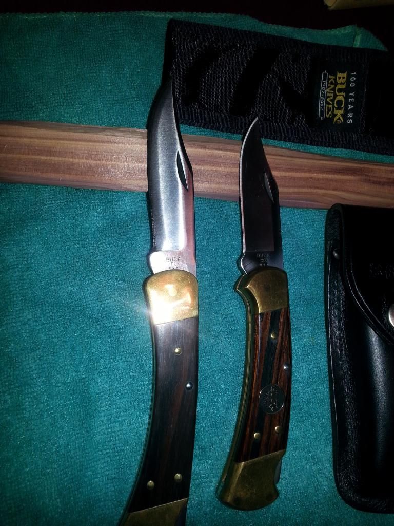

I remember the little care brochure in my first Buck 110's box cautioned against laying the blade too flat against the stone when sharpening lest you flatten the "shoulders".It even had a line drawing of a cross section illustrating the flaring out right before the edge that it said was to strengthen the edge.I think that was in 1982.This 1977 2 dot has it though I could not get it to show in this pic very well,the 112 is a 100 yr Buck anniversary model.
Willis, i think the picture does an excellent job of showing it if you what to look for. Very similar to mine.
