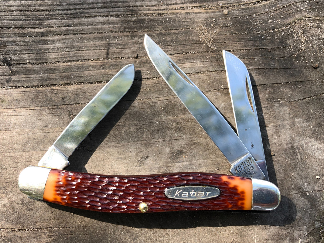

My favorite standard clip, made more utilitarian by the slender and very pointy pen third blade.

I'm not sure what I'd call this blade shape now. Post-Turkish Clip?
