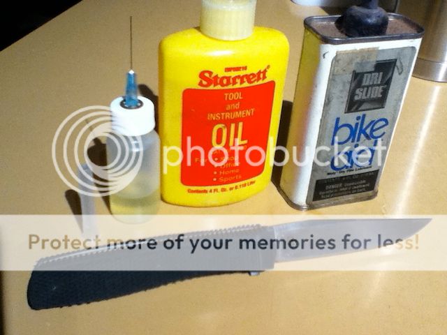

Two lubes I would recommend that I have tons of experience with for low drag applications :
This first one is a bit black and smudgy so at first you may want to keep a paper towel like wrap on your knife until you know there will be no more "excretion". There may be none if you are sparing. It is hard to be sparing with this stuff because it is so unbelievably thin it RUNS like lightning out of the hypodermic like nozzle that is usually supplied with the container. It is
DriSlide. Agitate it very well before using or you will just get solvent coming out and no graphite lube. I like to put a small nut or two into the can to help stir things up. Goes on very wet like solvent; leaves a DRY graphite film. This is . . . compared to ANYTHING ELSE I have tried in forty years of magic elixirs . . . THEEEEE THING to put on a control cable that has drag. Even fairly obvious RUST it just kills it and the thing glides effortlessly.
Second . . . and this stuff stays wet because it is basically just oil but oh such a low viscosity oil. It is
Starrett Instrument oil . . . the reason I like this is that it is just freekin' simple. No BS, no magic particles of teflon to gum up the works, does not thicken or do any thing "high tech". It's just thin oil and it WORKS !
On my own stuff I almost never use or need the Drislide. At work I use it when I am faced with a cheaply made and out of date (irreplaceable) mechanism that MUST work and work with very little drag. THEN I neeeeeeed to use it.
At home, on my high quality and very well cared for stuff. I often use the Starrett Instrument oil. Think precision instruments.
My one flipper is my Grail.
The Starrett oil is in the unlabeled little bottle with the fine hypodermic. I also like this oil because it really flows into a pivot or slide quickly because it is so thin.

That "Starett" Oil that the one Brother had pictured honestly is a great overall lubricant for all kinds of machinists tools and I have a few Starett tools myself and I do use the oil on a few tools and other items I use. I've also heard that Victorinox has a comparable oil that they have recently started marketing here in the USA and I've heard good things about it too.

Thank you for that. And if the parts are relatively rust resistant it will continue to do so as apposed to something with oil or wet lube in it which is collecting grit and lint over time INCLUDING MY STARRETT OIL.
