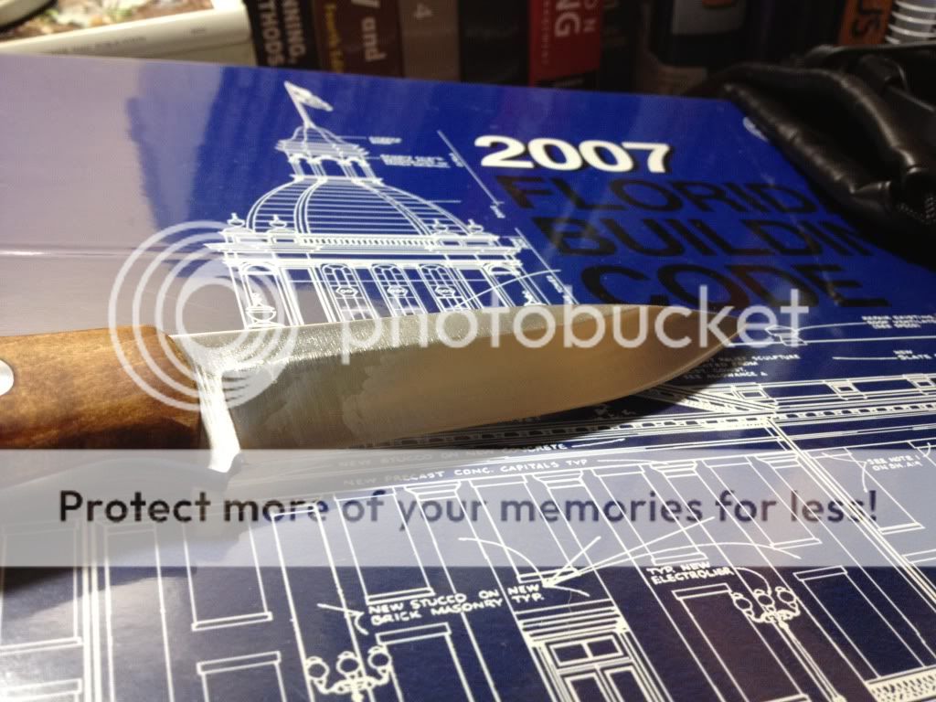

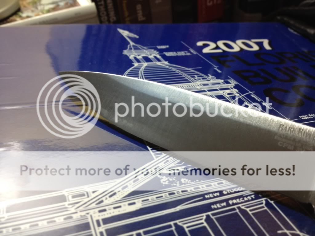

I received my Bark River Aurora CPM 3v the other day and while I was forming my leather sheath that it came with it appears moisture may have gotten to the blade through the saran wrap (I guess the knife cut it while wrapping, i dont know) and I noticed a few water stains on both sides of the blade. After a quick look through on several forums I bought some Bar Keepers Friend liquid and grade 0000 steel wool and I attempted to remove it. Not only can you still see it in when you look at the blade at certain angles but more importantly the Bar Keepers Friend left a HUGE white haze stain on the blade! I have tried everything to remove it with no luck. How can I get this off? These are the things Ive tried:
- one more application of Bar Keepers Friend, this time removing it a lot quicker because I was scared to do further hazing.
- lime and 00 grade steel wool
- Flitz polishing compound (apply with paper towel, remove with micro-fiber cloth)
- Ballistol and 00 grade steel wool
NOTHING works, just gets shinier on all areas outside of those locations. On one side of the blade there is only a stain close to the edge, running about a couple inches in length, on the other side it is a lot worse, covering nearly half the blade.
Do you guys think Bark River Spa Treatment could be a viable option? I am just somewhat hesitant because I literally have not even cut a clothing tag with the knife yet.
(Any mark you see is a stain that wont come off. This angle doesnt show it, but that haze continues to the tip.)
(Here you can kind of see the original mark that the wet sheath gave the blade along with the white haze)
The steel might've been etched somewhat by the Bar Keepers Friend. If left in place too long, or if not used with sufficient water, the oxalic acid in BKF can literally eat the iron in the steel, which will etch it.
BKF works great for rust removal (because it eats the rust), but it's critical to read the warnings on the label. I use water to make a paste with it (I use the powder form), and apply it with a Q-Tip or something similar. Wet the blade first, before applying the paste. Don't apply more than is needed. Rub a little bit, and don't leave it on the steel longer than maybe 30 seconds (BKF recommends no longer than 1 minute, at most). Rinse it off completely under running water.
For a waterstain (basically an oxide layer), my first choice would've been to use some polishing paste like Simichrome or Flitz to remove that, before trying the BKF. If the steel was etched by the BKF, polishing pastes can't fix that after the fact.
Being that this knife is brand new, I think sending it back to Bark River for the spa treatment might be the best option, if they're willing to do so. They'll likely have to sand/grind the blade, to remove the etched stain.

Yeah, I guess its just best to send it in... Clearly my home remedies have further exasperated the problem lol.

Anyway it does seem to be etched, and a few light passes on a belt sander would probably clean that right up for you.

The knife came in perfect condition when I purchased it new from KSF. It got stained, then subsequently etched by Bar Keepers Friend, when i wrapped it in plastic and stuck it inside a wet leather sheath so it could form to the shape of the knife. I guess the blade edge cut the plastic when I stuck it in the sheath and it was left exposed in certain areas, causing some water stains. Trying to remove it with Bar Keepers friend (improperly might I add) created the etching. I left the solution on for too long and applied it to a somewhat dry blade. When I sent it in to Bark River they fixed it no problem and shipped it right back. All is good again.
