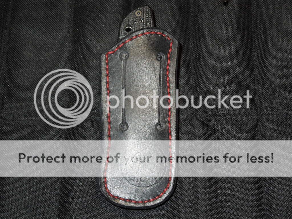

I use mainly sewing thread waxed with a thickness of 0.8 mm and 1 mm.
In fact, it is hard to be found in google slam but please:
http://www.hellotrade.com/ct-point/slam.html
In Poland it is only available in basic colors in several stores.
As for me, is just right, neither too much nor too little waxed.

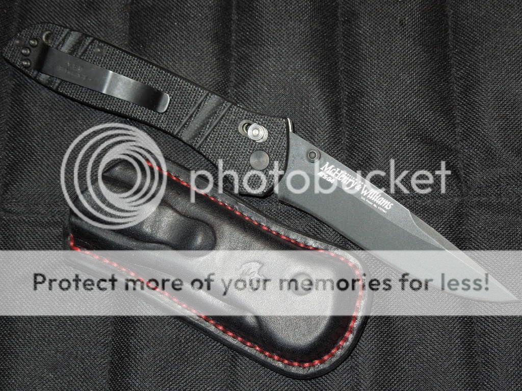

Some new sheaths.
104 Protech Runt Automatic and D25A Clicky simple pouch.
Spyderco Endura
Spyderco Paramilitary and Military
PCK :)

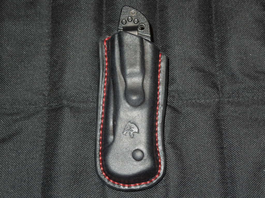

Im new to the leather scene, and im really curious how you get such crisp lines. As far as im concerned, the detail on this is outstanding. Are you just hand forming it? What tools do you use? Are you using a press or some sort of foam to make these so perfect? Im sure your wet forming, but do you add heat to the drying process? Do you have any tips for a newbie? Wow!
Thank you for your kind words.
Let me post a link to the photostory, once a customer has asked me to do so.
It shows the tool that I use to form (I did it myself).
https://plus.google.com/photos/117448108815403719039/albums/5844075519459218081
As for molding leather soaking in cold water, about 5-7 minutes.
The first forming only do roughly the fingers.
Then I try to do as much as possible with the tool to form.
Then use a hair dryer for 2-3 minutes but only cold air.
According to me, this facilitates forming finishing. Leather hardens slightly.
Some in the final process put leather in the freezer and later formed finishing.
Do not use hot air for drying, it is best to dry the sheath at room temperature for 24 hours.
I think it's all about molding.
If you have any questions, ask boldly. I will try to answer.
Thank you.
