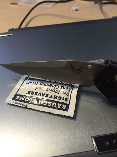

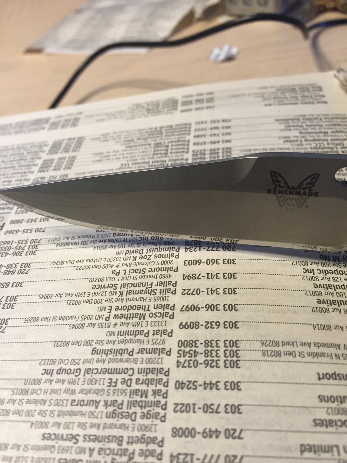

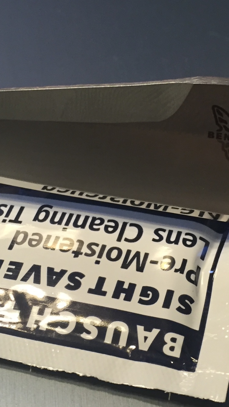

Well the heck with both sets of ceramic stones for me. 1200-1400 only worked on half my edge, 1.4/.6 micron don't act like 1.4 or .6 or I don't know how to use them. I did my BM 943 blade today, reprofiled to 15dps, worked my way up from 100g to 1000g then tried the 1200 ceramic again and got caught between degree settings on the rod adjustments so I went back to 1k and straitened out the mess the 12k made. Then I went with 5 and 3.5 micron diamond past strop and it looked pretty good. My 1.4/.6 ceramic stones showed up today so I lapped them and tried them out(they are the same size as my diamond stone paddles so no problem there) but they scratched up the polish the strop made, didn't make sense. I went back to the 5 micron strop and took out the scratches the ceramic 1.4 made and spent about 10 more minutes stropping before going to the 3.5 and spent about 10 more minutes with that. Came out pretty dam good to me!

Just did my manix in s110v last night and ended with my 1200/1600 to a semi polish
