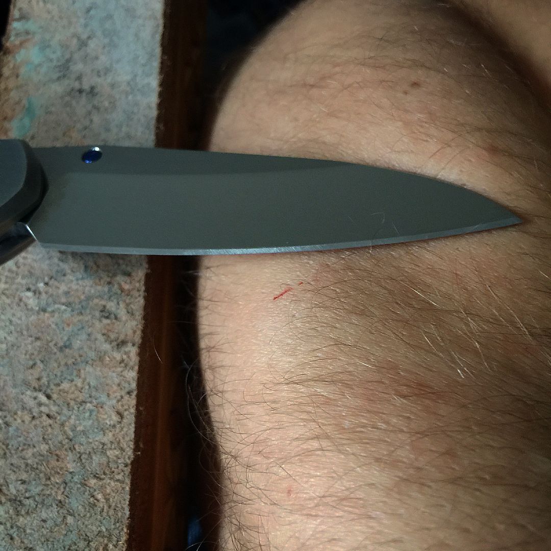

I did do my Mnandi and Insingo this morning. I went with 19 degrees, and it didn't take all that long. I have been stropping them on another system for some time (and poorly), so there was a bit of re-profiling that needed to happen in order to correct rounded edges. A couple things I may have done wrong:
I went trough a wire edge from 100 up to 600, then stopping worrying about it through the rest. I finished on the .5 micron strop. They are pretty darn sharp (shave hair like a scalpel). I've also noticed that: to my untrained eye, the bevel looks slightly different from one side to the other and looks to be the same on both knives. I zeroed the digital gage and set each side to 19 "even" at the 100 grit only. Is it possible that my clamp is not holding the blades perpendicular to the granite? I might need to clamp a deeper blade and check that.

Here's my Insingo taken up to 1K and lightly stropped on chromium oxide. Too sharp, apparently!
