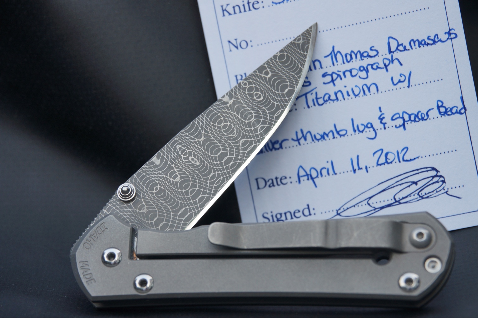

I sharpened my friends basketweave mnandi on my WE, and it turned out great. Unfortunately it had a really uneven grind. The only thing to be cautious about it the small height of the blade. Since it extends only a small bit above the WE clamp, you might need to set it higher then the top position you can reach with the 'stoppins'
Otherwise you might hit the clamp with your stones.
As far as the comments on value, l understand them, but my knives are all used, and only 'mine' when l sharpened them myself.....
Goodluck
Niels
Ps.
Also works great on spirograph small sebbie
