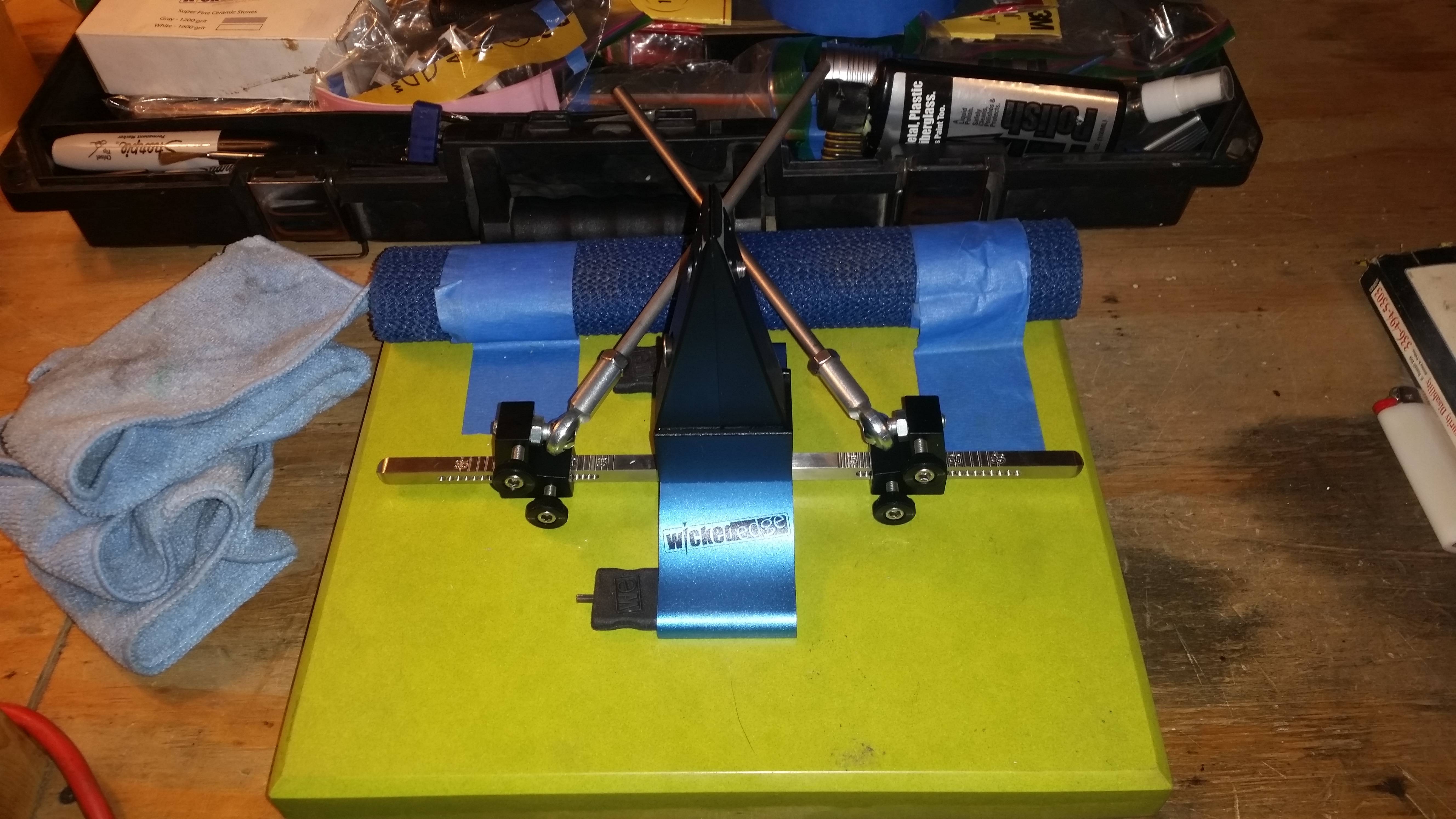

Super stoked just got my upgraded arms in. So much smoother operation over the original ones.
