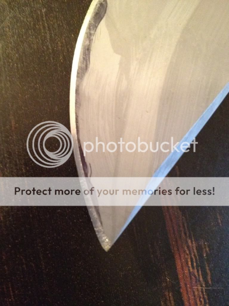

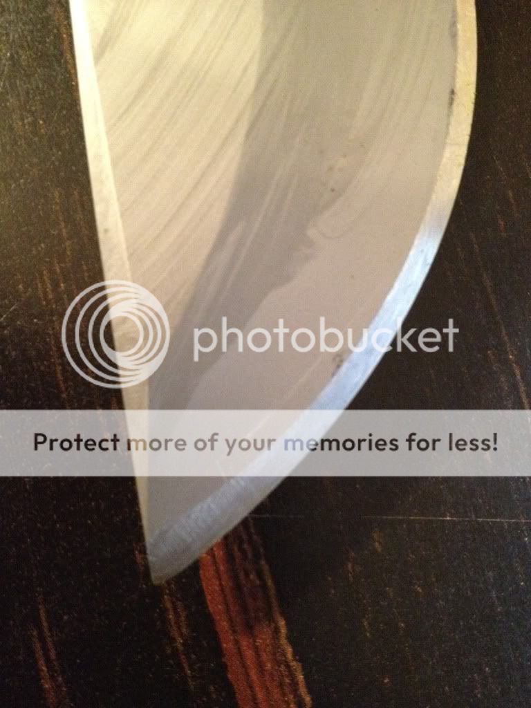

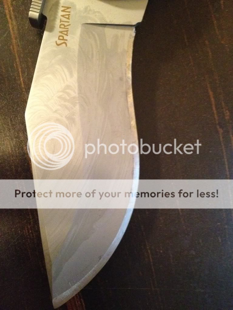

I have had the same problem with each of my cold steel knives. I think I am screwing up my blades. I have sharpened 3 blades now and the same happens on each. The first side I sharpen is the right side. I will pick my angle, put marker on the blade, and sharpen until the marker is gone and I can feel a bevel on the left side. I then repeat the same step on the left side. Typically the left side can take as little as a few strokes until I feel the bevel along the right and then move up in grit. However, when I originally do the right side it can take hours of sharpening until I am able to get rid of all the marker. Yes, the degrees are set equally for each side. Also, if you will notice the new edge becomes increasingly wider as I get to the point of the blade. You will notice in the pictures the right side (the side without the marker) is wider than the left. Please let me know what is going on so I stop ruining my blades.

Is your bevel the same width on both sides of the blade? If you start off taking everything off just one side until you get to a burr, you're going to end up with an off-centered edge, which will be wider on one side.
One of the advantages of the WE is that it lets you easily take metal off both sides in tandem. It's easy to keep a centered edge that way.
If it's taking a lot longer to remove the marker off one side, the angle on that side is larger than your sharpening angle. So, if you're sharpening at 15 degrees and one side of the edge is 15 degrees and the other is 20 degrees, it's going to take a lot longer to raise a burr on the 20-degree side.
It's normal for the edge to get wider near the tip because the angle geometry changes.

1) your are supposed to clamp the blade in the exact middle. I have found for blades with a large upsweep that I clamp them slightly forward of the middle.
2). The knife you have pictured has a decent amount of recurve. You will need the rounded wicked edge stones to have great success with recurve blades.
3) in Clay's videos he says he doesn't count strokes. I have not found a way to evenly re-profile an edge without using the marker trick and counting strokes.
If you stay on one side till you get a burr you HAVE TO stay on the opposite side until the edge is centered not just get the burr off, hope this makes sense.
This was what I was going to say. If you are reprofiling all on one side until you get a burr, then you will end up with an offcenter blade, one side appearing wider than the other.
In increades edge width at the tip is normal on an WE, at least for me.
