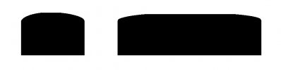

Good comment on the drawing I made above - did some more thinking last night and am now thinking perhaps a gentle curve rather than "fullering" type might be better. Press a gentle curve full width of billet to force it wider, then next press with flatting dies to level it out? With that full width curve there should be less chance of cold shunts/inclusions.
and of course "Kisser" blocks would be used to control depth of groove. I do NOT have anywhere near enough control of the press without kisser blocks.
That's the safer, but slower way. You'll probably quickly get to the point where you do multiple passes with the drawing fuller before switching to the flat dies. As you get more motor control you'd be able make those fullers narrower to work faster, but I bet the difference would be minimal with the power of the press. Untitled.jpg
Your sketch is a ladder patterning die. I think you would get better fullering with opposed high spots, instead of alternating them.
Now, if you were shooting for adding horizontal wave pattern to damascus, then your dies as-sketched should create some changes in the pattern.
Personally, I would make a single low arc on the dies.

Here's a quick sketch of what I think are the best shaped "combo" die profiles for drawing out billets. This is the side and end view of an ~ 3" x 6" die that's on the 165# Wolf power hammer that I learned on. I'm not smart enough to know if this size/shape would be the most efficient on a press, but my point in sharing this is to try to demonstrate the general shape of drawing dies. There's a large radius to squeeze the metal from the center out to the sides, thus stretching the bar. But there's also a large enough "flat" spot to straighten and flatten the bar during the drawing out process.
