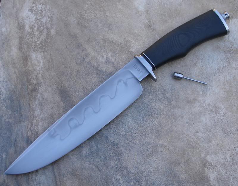

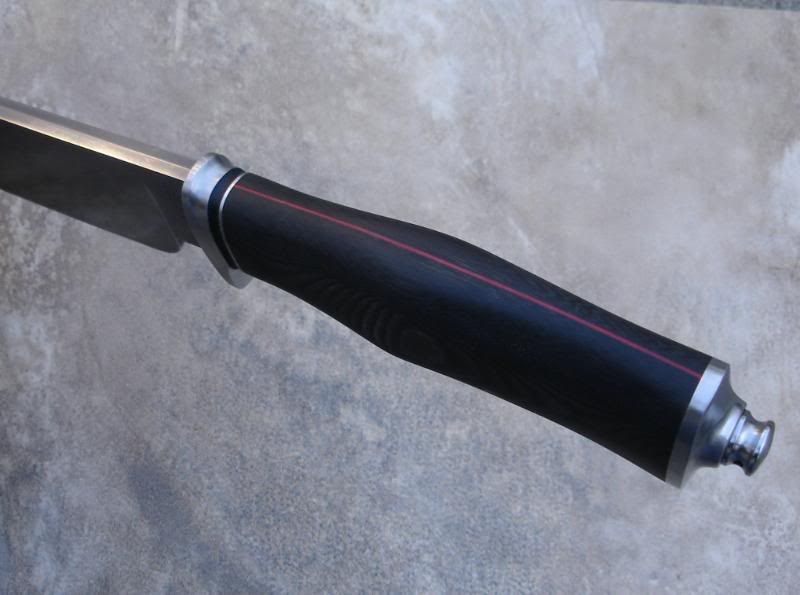

One of my collectors asked if I'd make a "Take-down" Camp knife in W-2.....with a Micarta handle... I tried to resist... I knew I should'nt do it....but I love that Black Linen Micarta...
...and that Thin Red Liner...

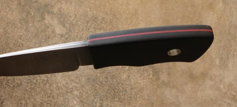

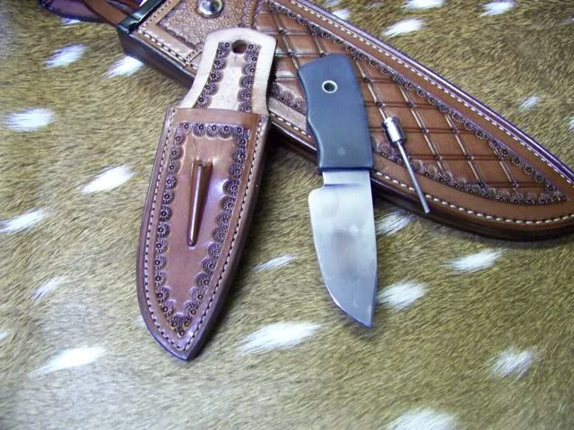

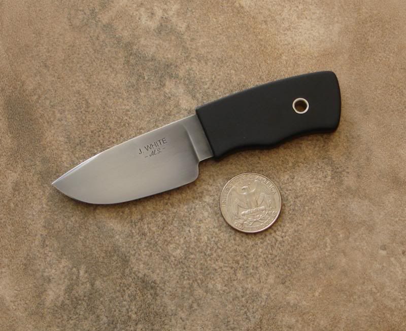

...then I thought, "I'm already involved, it wouldn't hurt just to make a Thumb-nail Skinner with more Micarta for the handle."
...with more of that Red Liner, and tiny Facets on its tiny blade...
..after all, its a Take-Down, the Mammoth will never suspect...

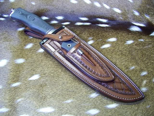

...Then Paul Long took photos of the wardrobe I bought her
...and put them on the internet...
..now everybody knows.

Excellent work John as usual. Love the W-2 and the micarta, especially the thin red accent. Beautiful set. Great hamon.
Nice camp knife! The addition of the skinner is a great plus, and Mr. Long adds it perfectly to the main sheath! :thumbup:

I saw the first pic and immediately thought, "Jeez, how the heck did he broach a micarta block for the tang???" Thankfully your second pic explained it quite succinctly! :D

That set looks awesome, I really like the takedown aspect and love the overall look of the camp knife. The sheath looks great and blends the 2nd knife perfectly in with it. Overall the package looks great and whoever gets it is going to be very happy. Great job.
Now that's what I call a premium working camp set - the micarta choice makes sense here and looks good to boot. The red liner was an inspired choice. Paul's kangaroo sheath rocks. Great job all around. :thumbup:

Hey, I'm glad ya'll like these knives and their really neat P.L. sheaths. They were fun to make. The handle to the Camp knife was epoxy cast to the polished and waxed tang. I had to baton it off, and lightly re-sand and polish the tang for a snap fit!
