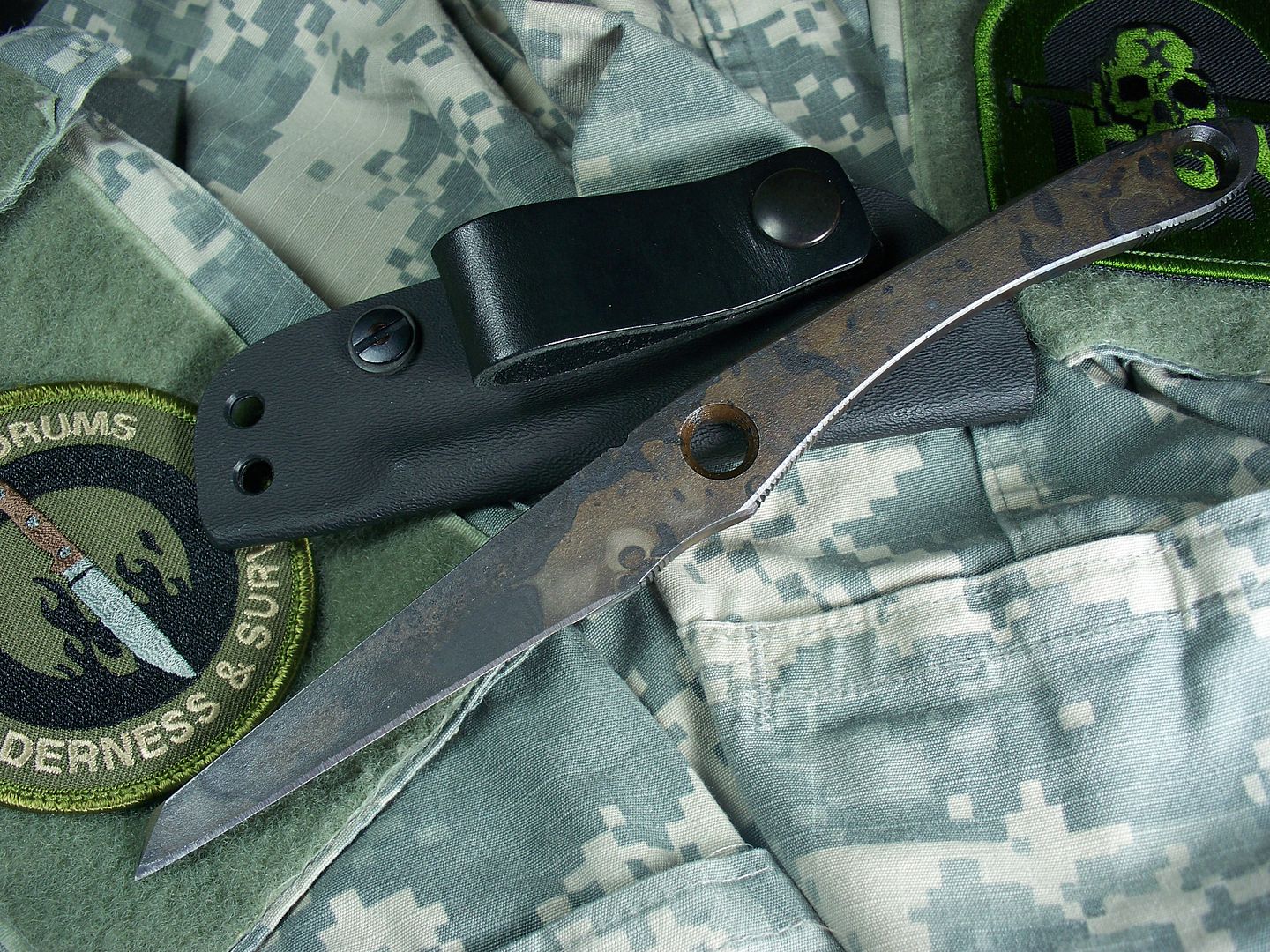

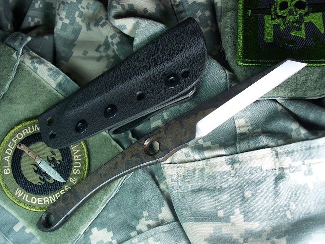

1/4"+ Thick Ultra Tough 5160 Steel
9" Long - 3.25" Blade
Integral Design - Slim and Tough

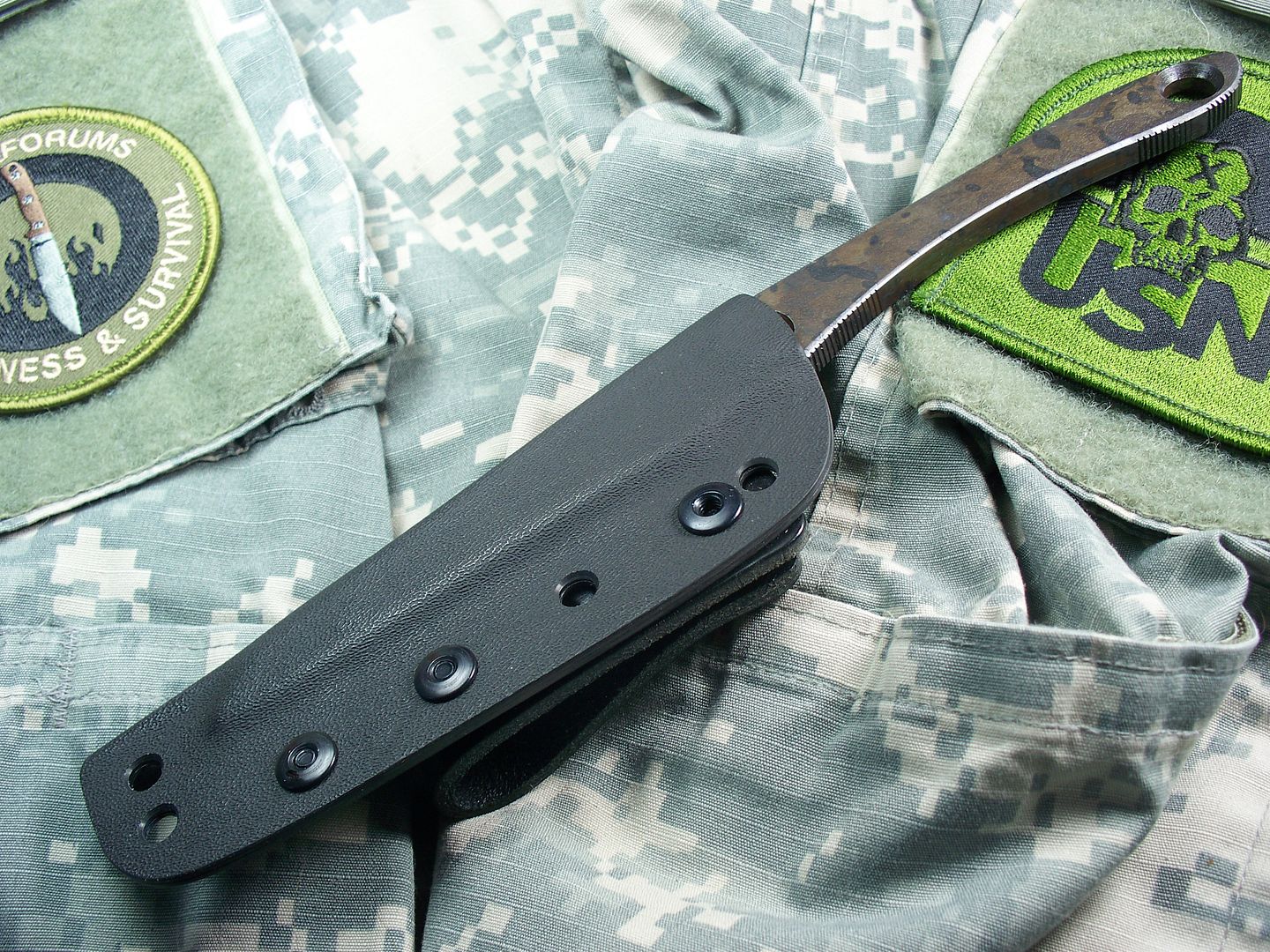

Internal Waistband Carry - Currently set up for reverse grip carry behind the hip, Sheath is also teklok compatible in multi positions
Knocker Pommel
Strategically Placed Jimping
Chamfered Handle for Comfort and Grip
Two deeply chamfered holes in handle for grip, sheath retention, lanyard carry or paracord guard
Deep chisel grind for a nearly triangular blade profile - microbevel on both sides
Forge Finish with Satin Blade for durability and an easy to maintain finish

I really love that design Daniel, and what kind of finish is that? Gnarly piece Sir. So is that a Chisel grind with a slight edge on the backside? What kind of grind is that exactly? Does it slice really well?
Sid
Sid

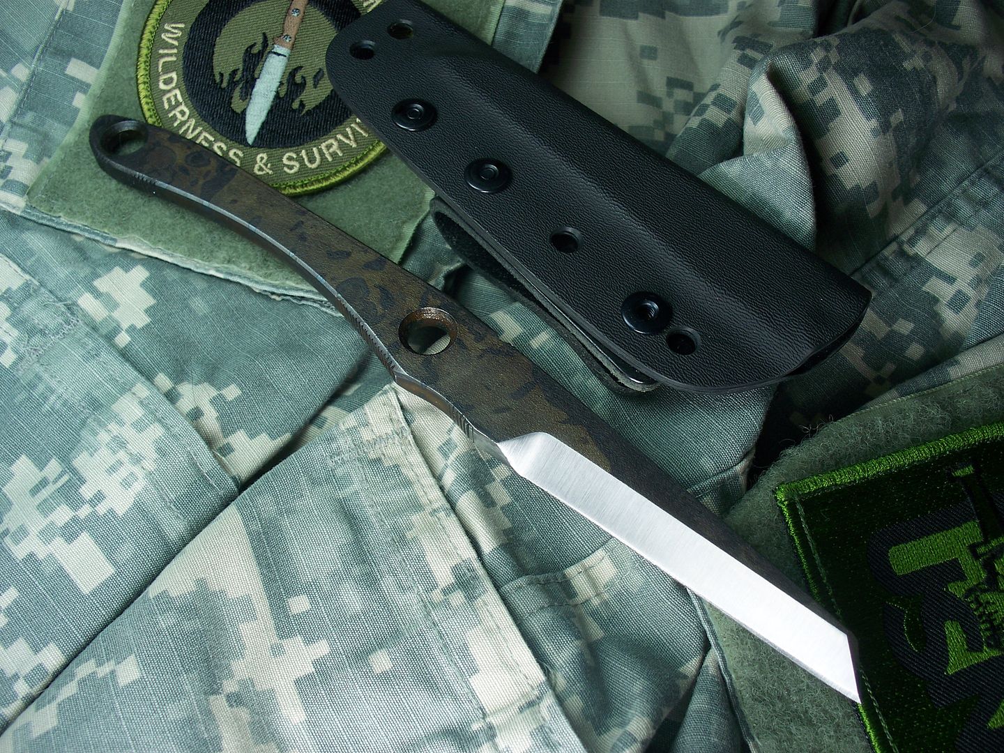

Thanks! It is a forge finish. 5160 comes with a thick scale layer on the outside when new and I further manipulate it to get that gnarly look. The finish is textured and tough as can be, the toughest stuff you can grind in my opinion.
Yes backside edge and and one on the chisel side for maximum strength. It does not slice well with this extreme deep hollow triangular geometry but excels at piercing and that sort of thing. This one is made for strength and all out battle.

...By the way that forge finish is what thy call "decarb," it is a layer the steel forms as carbon migrates out at high heat. It comes out differently each time and is pretty much up to luck.
I understand the need for slicey grinds and while I make "hard use knives" I feel they really need to cut well. Every once in a while it is nice to make something that breaks the mold though. Even my .315" folders will be very slicey with a fine edge.
Oh yes, that's what I pray to Crom, and even though he "doesn't answer prayers" (Conan Ref), I'm putting the prayer time in anyway for thick-ass slicer grinds on future Fairly Folders : ) Hollow grind seems to slice the best from what i've seen. Probably why old timey razor blades are that grind. Thin Spyderco flat grind is slick too.
Decarb is fukn cool man, reminds me of my home town of Pittsburgh, and I can see the images of molten steel with the slag on top right now in my minds eye. Very cool too how it looks like some cool organic camo design.
