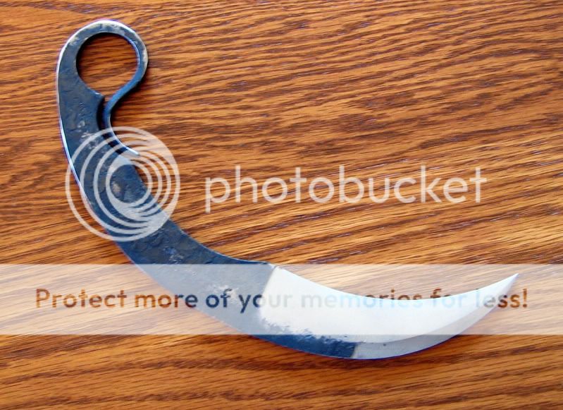

Actually Ken... hold off a couple days before resharpening... I'd love to get a looksee at the damage. To see it it chipped or rolled. Funny that its at the tip... Is that where you were chopping from?

I want to qualify the edge damage critique. First, that was a macro shot at 200 mm telephoto lens about 8" away and then cropped further. The blade was also tipped into the sun in order to show the damage to maximal effect.
My wife looked at the thread and later said to me, "let me see Rick's damaged knife", like she was all concerned about it. I showed it to her and she's says "did you photoshop that damage in? I can't see it".
I point it out to her and she is still saying "I can't see it". So I says, "run your nail across the edge to feel it." She didn't like this prospect much, but the thought of calling me full of BS intrigued her enough to try it. Sure enough she did say, "yes I can feel them now, your photo makes it look much worse than it actually is".
[Okay Rick how is that??? Please stop threatening to beat me with my own shoes now..........No actually, I'm just teasing in the italics part of this post, Rick actually wants to see the knife so he can learn from it and my wife actually could not see the little pits in the blown up photo!]
LoL..... No worries Ken.... All knives get dull and ALL knives can get damage like that. I only want to see it to find out if it chipped or rolled. I'm not worried about rolls, dents or dings.... its the chipping that I'm afraid of. I don't want the knife to be too brittle. "Better to bend than break." is my moto.

Well, Ken allowed me to view the edge damage on the SCurve over the weekend. I am okay with how things looked. There was some deformation of the edge but no chipping. the edge still shaved amidst the dings which tells me its not too soft either. I'm pleased with the results and thank Ken for the opportunity to study the aftermath of his vicious destruction testing. He even showed me the hockey mask he wore during the ordeal.
