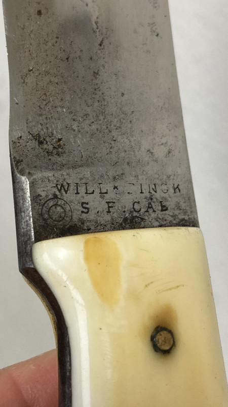

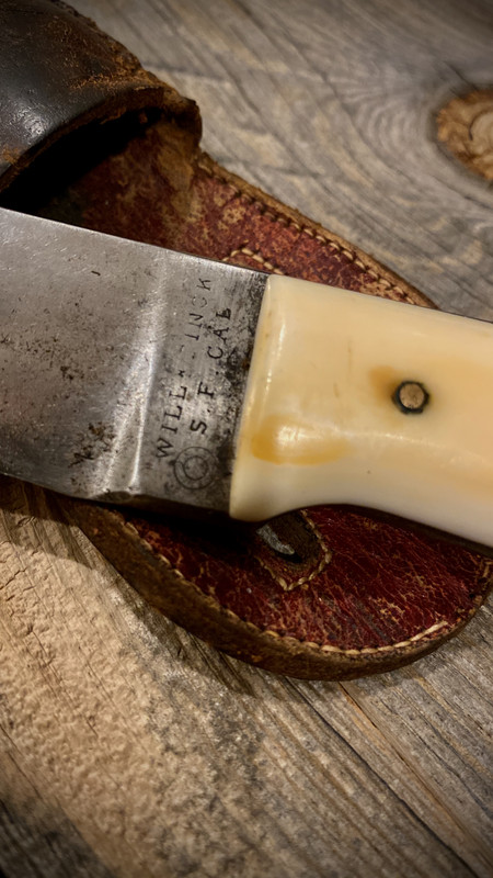

I'm so torn by this.
Ticks me off too!! I think I've seen that stamp before on a push-dagger!!:mad:
Definitely fake, based on the raised edges on the stamping pointing to cold stamping on a finished knife.

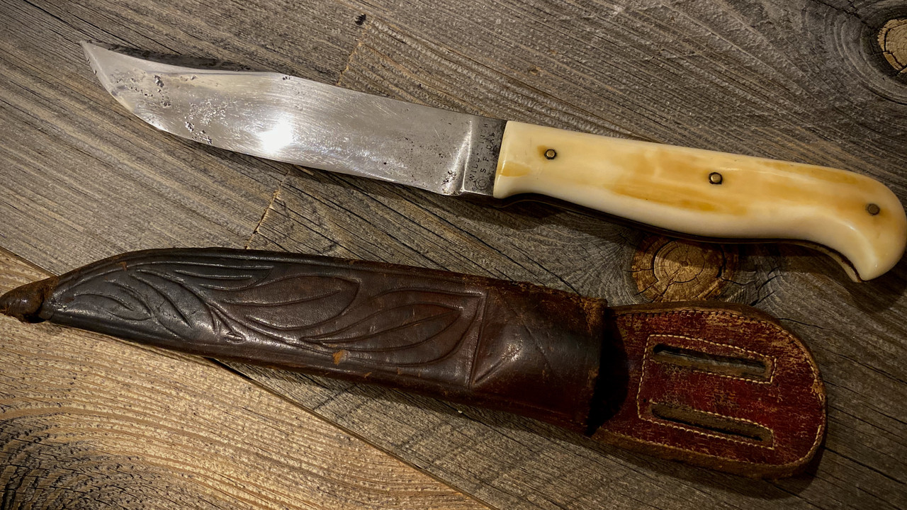

What scares me is that looking at the whole knife I would think it's real, of course some of that is just not knowing what to look for.
If you look at the OP’s first picture...study it closely..notice the white color around the letters of the tang stamp... that is metal displacement from being stamped “Cold”. Usually found on fakes. Never on authentic Antique Bowie’s/ dirks/ hunting knifes.
