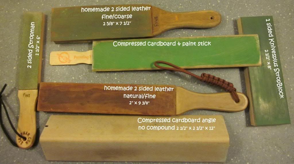

The debate goes on...rough up/smooth up. I wanted to know also so I checked what I could on the subject and found no clear consensus, mostly opinions. I chose to try smooth side up using (because I had some around the house) Gorilla Glue as my adhesive. I first used a sanding block to uniform and rough the surface enough to hold the compound. I say use your belt whichever way makes your boat float but sand the surface to get rid of whatever impurities maybe on it.
Photos of all my strops except one I made for recurved blades. Hope this gives you some ideas.
Btw, my favorites one is the one in the center with the lanyard.

Nice assortment. Where did you find the paddles used in your home-made strops? I'd like to make several that are wider than my paint stir stick, if I can find leather to fit them.

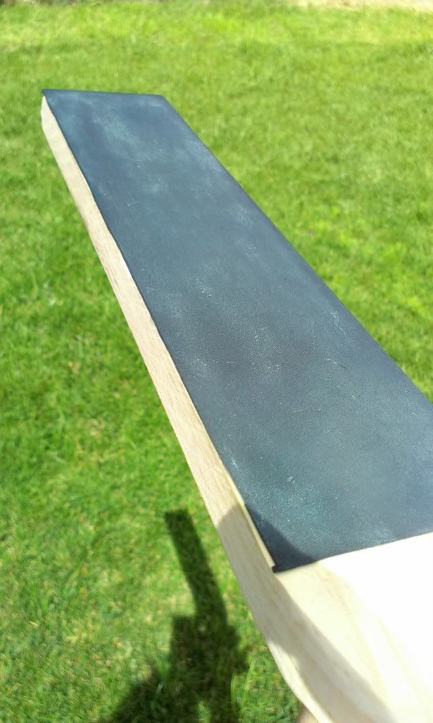

SwampDude, if you like, send me an email with your address and I'll send you a bit of the leather I use for my strops. Aside from the qualities I mentioned, it's also extremely thin. It truly is excellent strop leather.
You can kind of see how thin it is in the pic.
The only thing I wish is that it wasn't black, but I haven't found it again at Tandy, let alone in another color.
