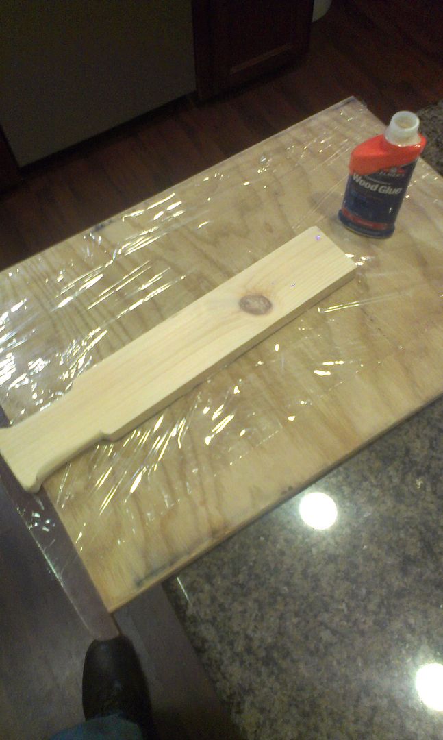

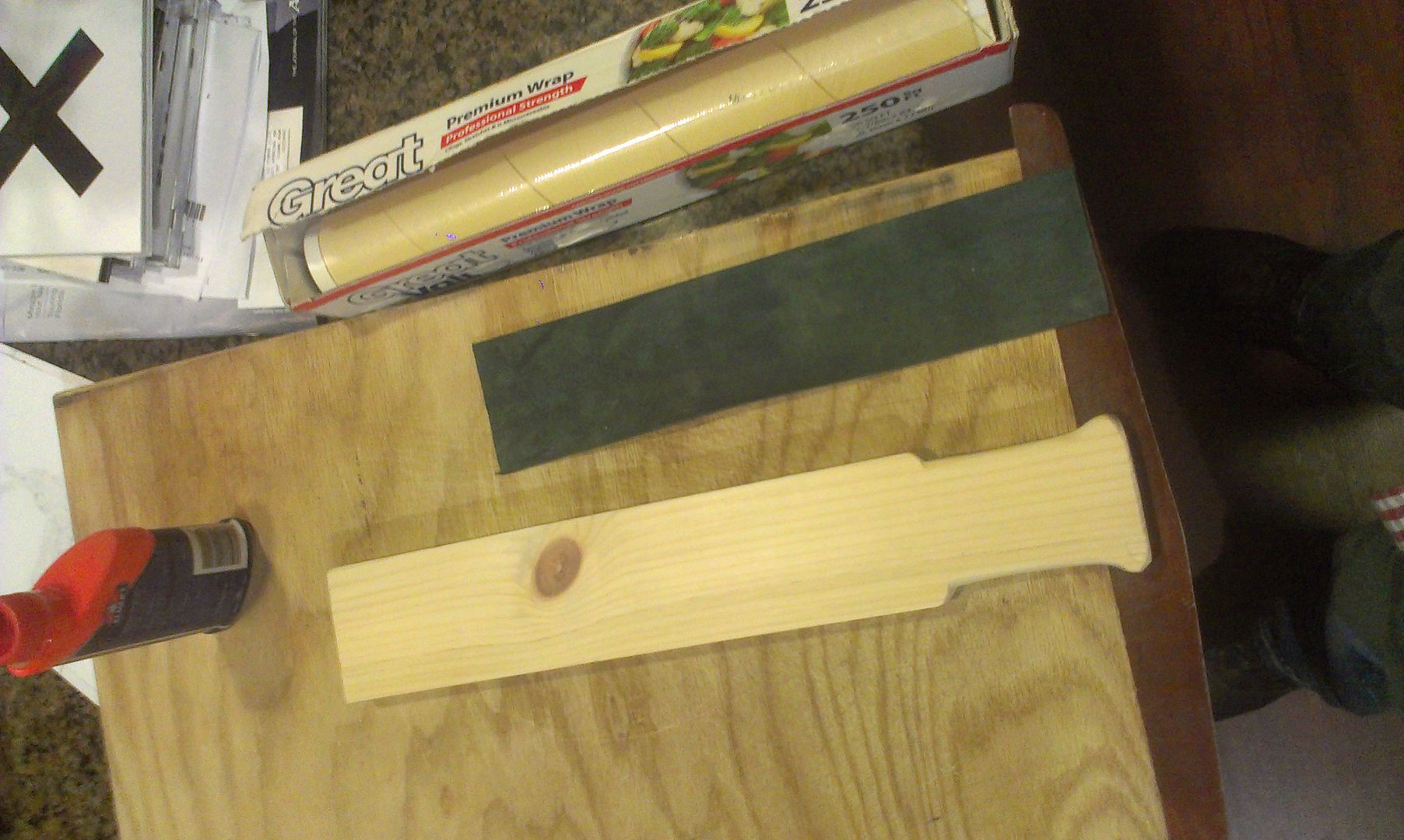

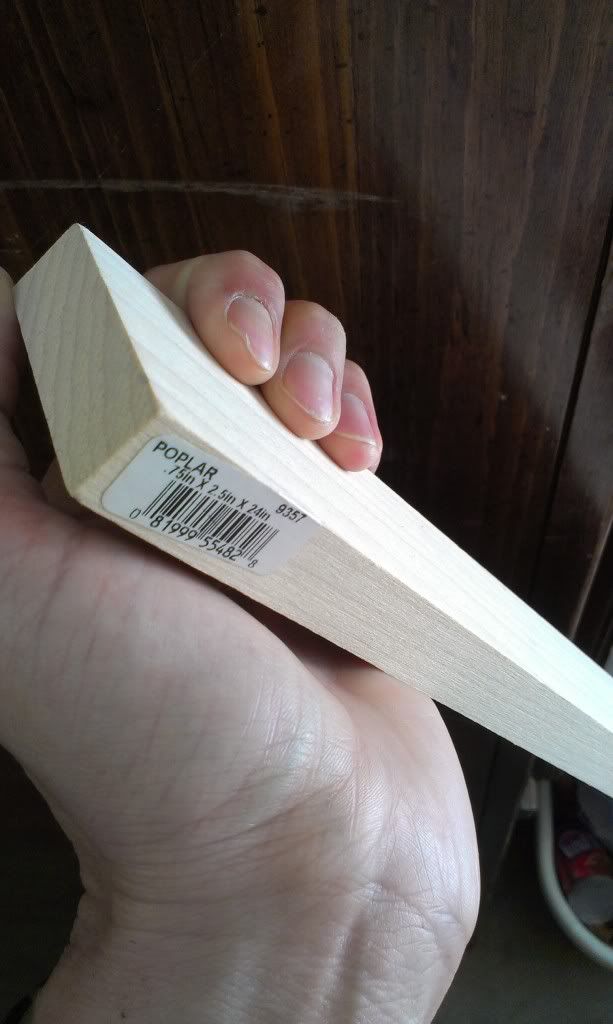

I attach my leather using Elmers wood glue. Works really well. I buy poplar from Lowes, it's flat and strong. I grind down a handle at one end but it's not necessary.
What I do-
Cut wood to length
Lay wood on top of hide
Cut along the border of the wood with a utility knife
Put a thin layer of glue on wood
Lay the leather nap down on a piece of saran wrap
Carefully place the wood down on the hair (glue) side of the leather
Flip over and check for placement and glue contamination
Using a new piece of plastic wrap place the strop face down and set a heavy weight on it
24 hours later I apply whatever compound I'm going to be using usually with some heat from a hair dryer
Spread compound evenly and sparingly
I have other pics, but I can't find them at the moment. :)

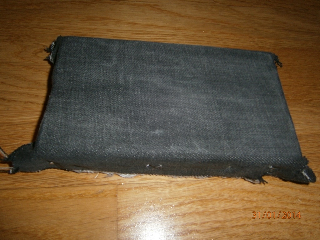

One very cheap material for a strop is denim. The strop below is about 4 inches x 7 inches. One side is just denim and the other side has 0.5u stropping compound rubbed into it. Seems to work quite nicely for finishing the edge or maintaining a good edge. I actually like it better than my leather strops. One reason is that it is wider and it seems to work well with the compound. In any case, very easy to do and most people have old jeans lying around so not much of cost either.
