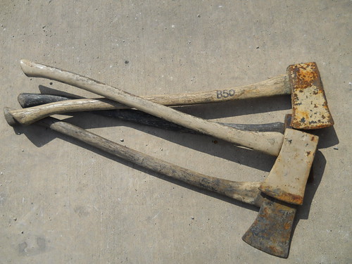

Kipper Tool makes the kits, and that head looks identical to me. Still cant find a close up showing marking though.
b by laghaxx, on Flickr
