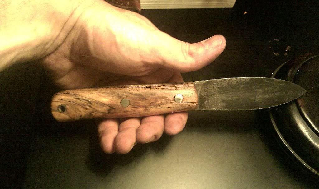

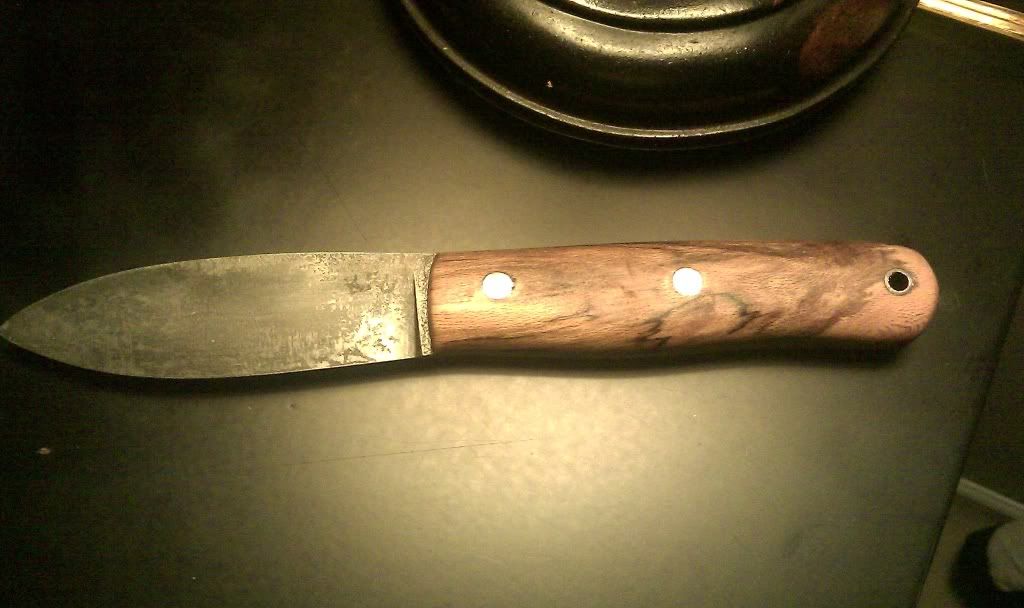

Here is a knife I am working on. I just put the scales on but have to add a bunch more coats of oil. Its Spalted Maple that is outstanding.This should be done in the next couple days along with a Bushcrafter in crotch walnut. They both will be getting my new sheath with the removable firesteel.

My hands are bigger than average but not huge. The handle is close to 5" and I think the blade is around 3 3/4 give or take. I wanted to make a no nonsense woods knife, thinly ground, that would be comfortable in all grips. I didn't know if I would like it at first but it is really growing on me. I might have to make myself one!
That is a great looking knife! I love that willow pattern. I didn't think I would at first, but I really, really like it! Those scales are suh-weet!!!!

I was the same way Mikey J, I almost prefer it now. J1M, I have to have a fullsize handle and I like smaller blades unless its just a large knife! As long as the edge goes all the way back to the handle IMO a 3 1/2" to 4" is really all you need.

Well, I woke up this morning and was going to put another coat of oil on this thing and noticed the handle had seperated alot from the tang. It was pretty hard wood but I guess not hard enough, note to self, get all spalted woods stabilized! Anyway, Im going to take it off and put something else on there and try a slight coke bottle shaping. Ive never done it before so Im actually excited to give it a shot! I think it will really help this design to have a nice palm filling handle that tapers off to the front and rear. Wish me luck!
Chris, this may be one of those questions that get the eyes rolled at it, & I know that possibly the only thing that knife making and wood working have in common is that both last words end with the letter "g", but can you get adhesive down in between the handles & frame, and clamp the hell out of it to hold it ???
Like I said, here cometh the eyes a rolleth . . . . :rolleyes: :rolleyes: :rolleyes:

I could but I don't know how long or if it would hold. I really loved the wood but I don't want to take a chance. I have about ten more sets of spalted sycamore and maple that will be going out for stabilization. I really prefer to use natural woods but the spalted stuff is just too soft.
