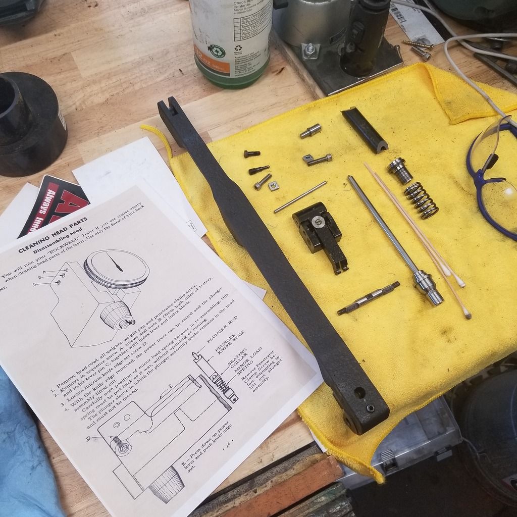

Cleaning it up now, going to fill up the dashpot shortly with some 10w non detergent oil then Re read the manual. Two penatrators also arrived today from China.

So everything was stiff, so a full cleaning, and disassembly completed. Used a heat gun, picks, razor blades to get the dried up oil/grease off. Relubed, dash pot filled, and missing nuts made and fitted. So getting consistant readings on some 1084 test samples i made. But still need to verify with known hardness, So JT if the offer still stands let me know and i can paypal you to cover costs/shipping. Once done, if any new makers in the area (Chesapeake Va) that want to test their blades let me know. (Free and beer included)
