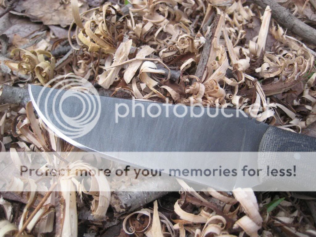

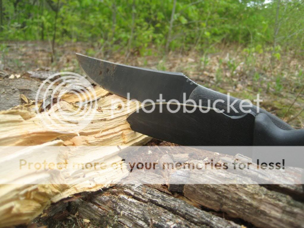

I went out last night with one thing to check out- handle comfort and grip.

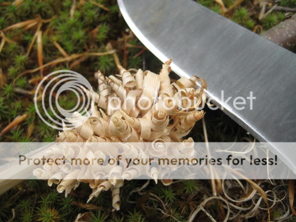

I did 20 minutes straight of wood shaving with no gloves. The handle itself is great and had zero hot spots. I did find as time went on, the jimping on the thumb ramp started wearing away on the web between my thumb and index finger. Wasn't terrible, but was there.
For full power stabs and slashes- there was no slippage and the grip is wonderful! :thumbup: I didn't capture some of the stabbing photos or any of the slashes...but I have to say the knife is a beast in these applications.

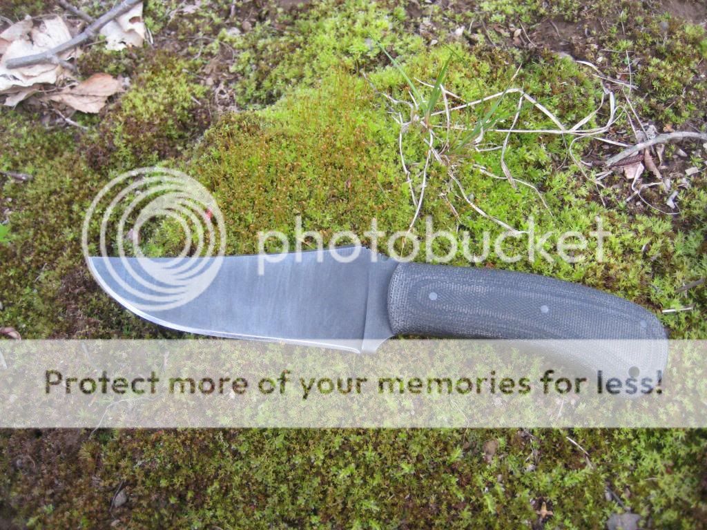

Something I could never tell from photos over the years is that this is a great looking knife! I love the lines of the blade and handle. I don't know if the photos capture this? I've been taking the knife out just to admire it.

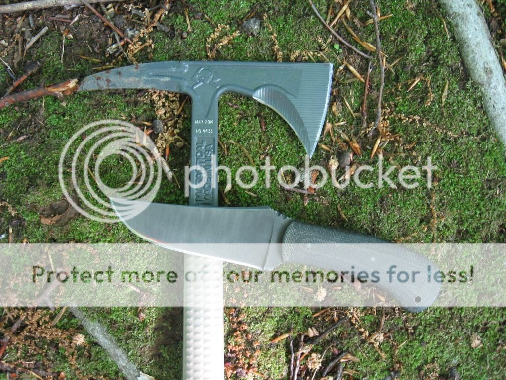

Does this knife scream to go with a hawk or what?!
That does bring me to the one glaring problem I've found with the knife. It's burning a hole in my brain making me look at Mr. Winkler's axes and hawks!! ;) :D I'll tell you- I can't stop looking at them and wondering..."If I sell this and that...I could get one without spending too much!" I don't even use hawks that much! Although I did use the SOG last night and forgot that it can be a useful tool.

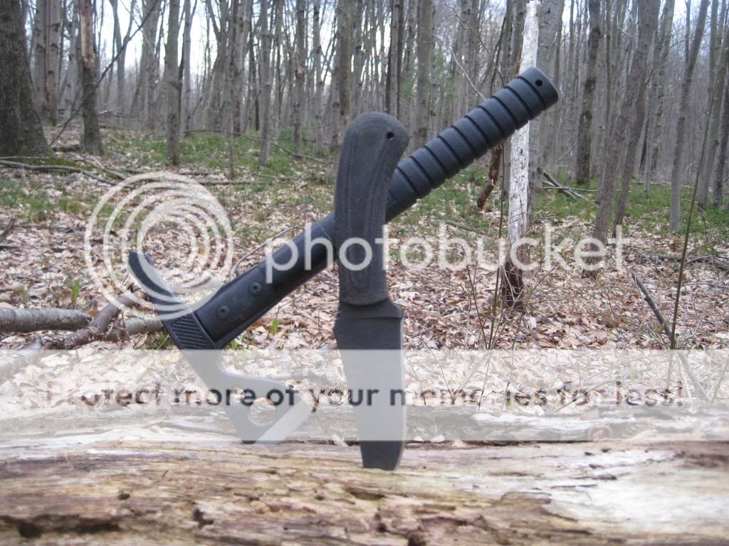

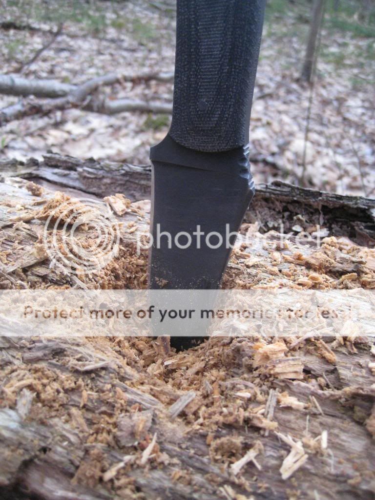

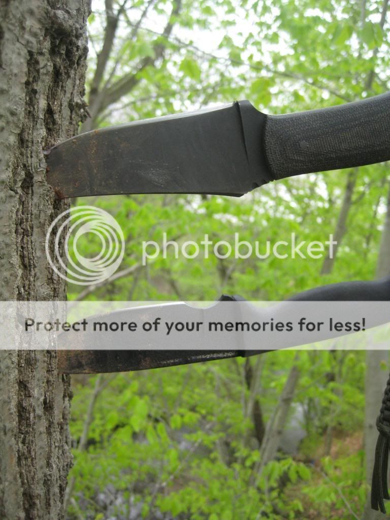

Probably my last additions to the thread...took it out with the Howling Rat to compare full power stabbing motions.
Grip on both was great.

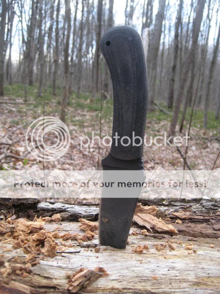

I must have done 30-40x total and I don't remember how many times the Winkler just splintered the wood- it was impressive! A number of times the Howling Rat would penetrate about 1/4" while the Winkler simply destroyed the wood.

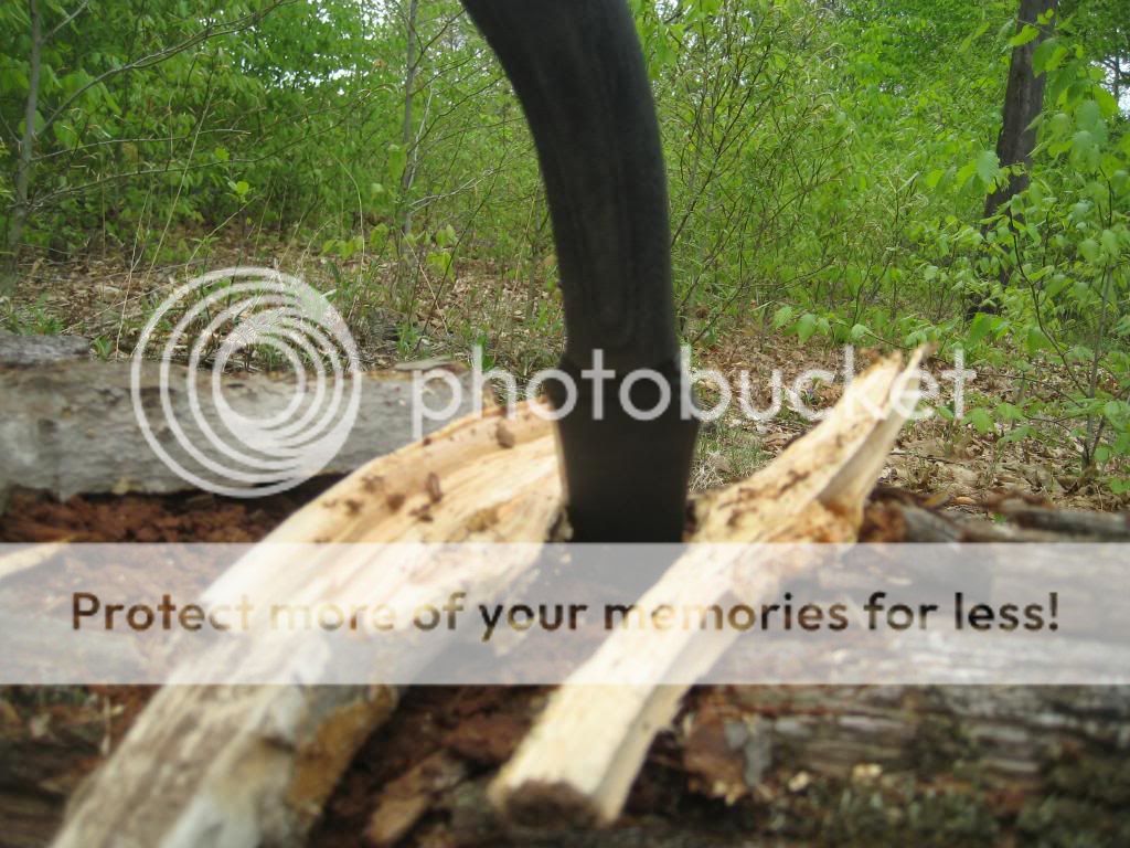

A downward strike with full power- great grip and hard to see, but the Belt Knife penetrates more.
Hard to see these slashes, but again the Belt Knife just lays it open..feels great in hand BTW...

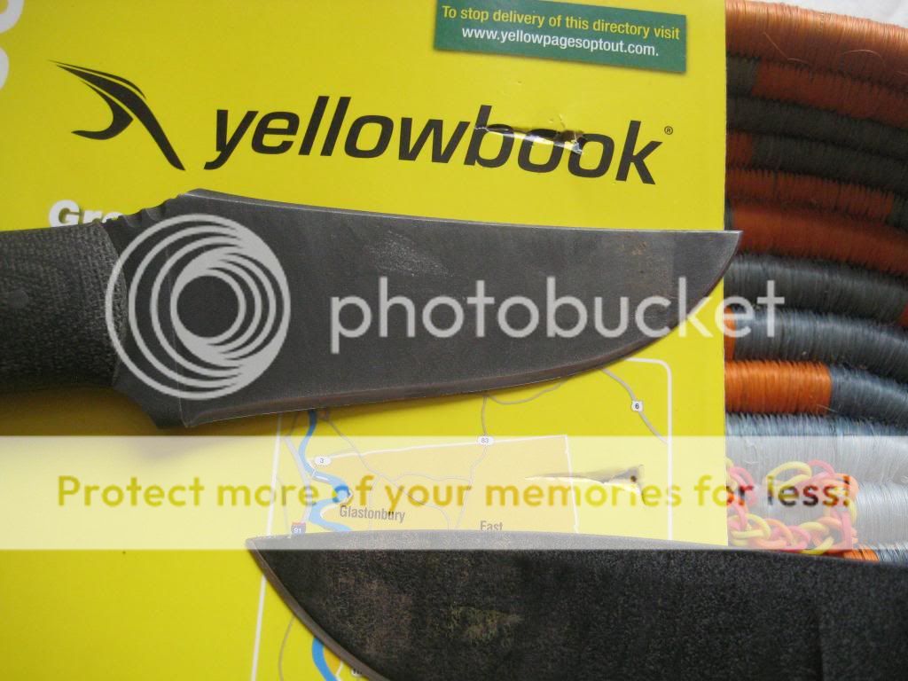

Tried a little more "scientific" :foot: stab test...on a phone book. Confirmed what I thought in the woods- superior penetration. Page 443 vs 365.

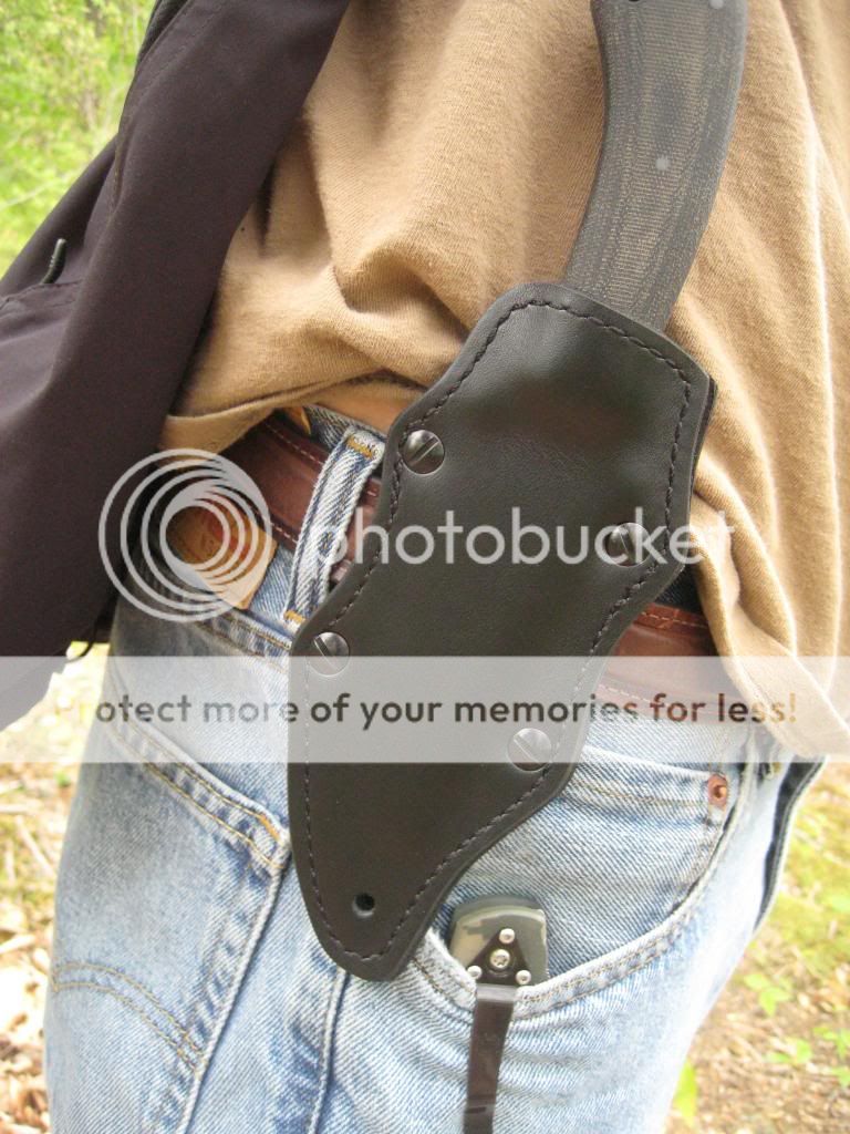

Thought I would post the knife in vertical carry- carries high. Love the sheath, retention is stellar and it's a looker. Plus being able to choose between vertical and horizontal carry is great.
