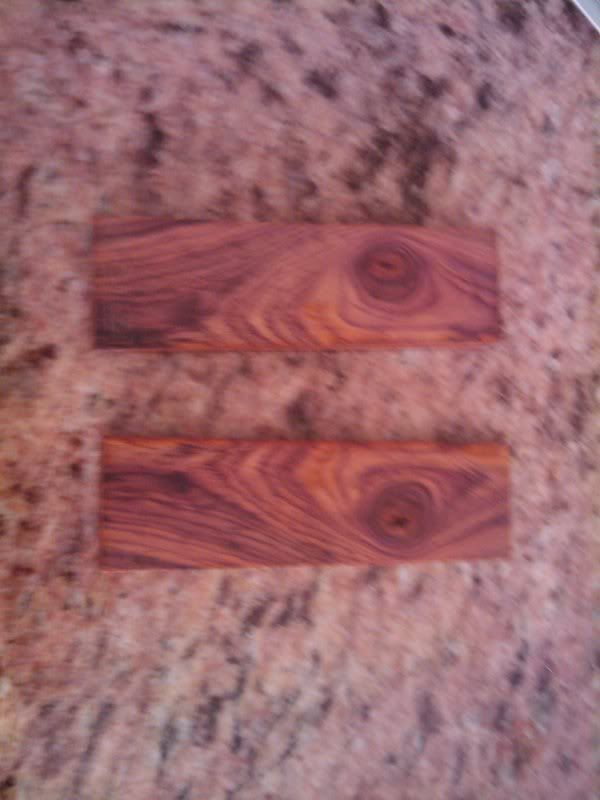

Got my scales in from Texas Knife Supply today.
Cocobolo (3/8in thick).
My dad and I are going to work on this over the course of this week!
Pictures:

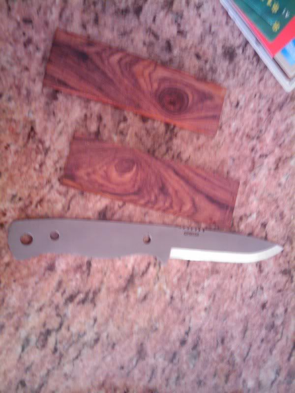

Well before I order the wood and mess up I had a question.
Should I glue, drill, cut, and sand?
Or Cut, drill, sand, then glue?
Or some different order?
I would drill, temporary pin and trace, cut oversize, temporary pin again to sand to fit tang, then pin,glue, & contour sand.
clamp the wood to the tang
drill the holes
then trace the outline
cut the outline
Counterbore the holes (as discussed in my email)
Finish out the fronts of the handles - since that' harder to do once it is glued up.
Then glue up
Best of luck!
Dan
Just that you need to drill the first hole at 0.220" then "counterbore" it with a 5/16" drill bit.
